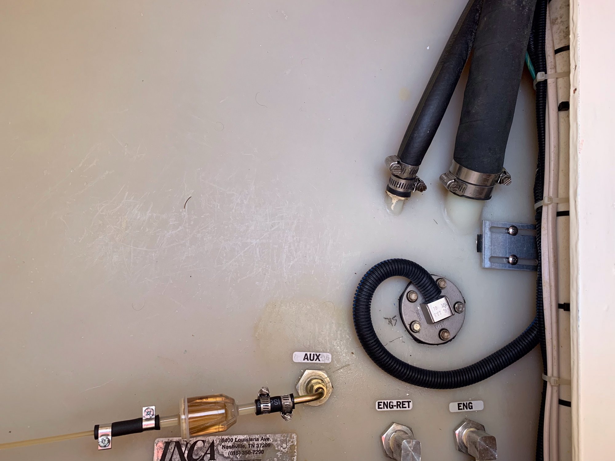

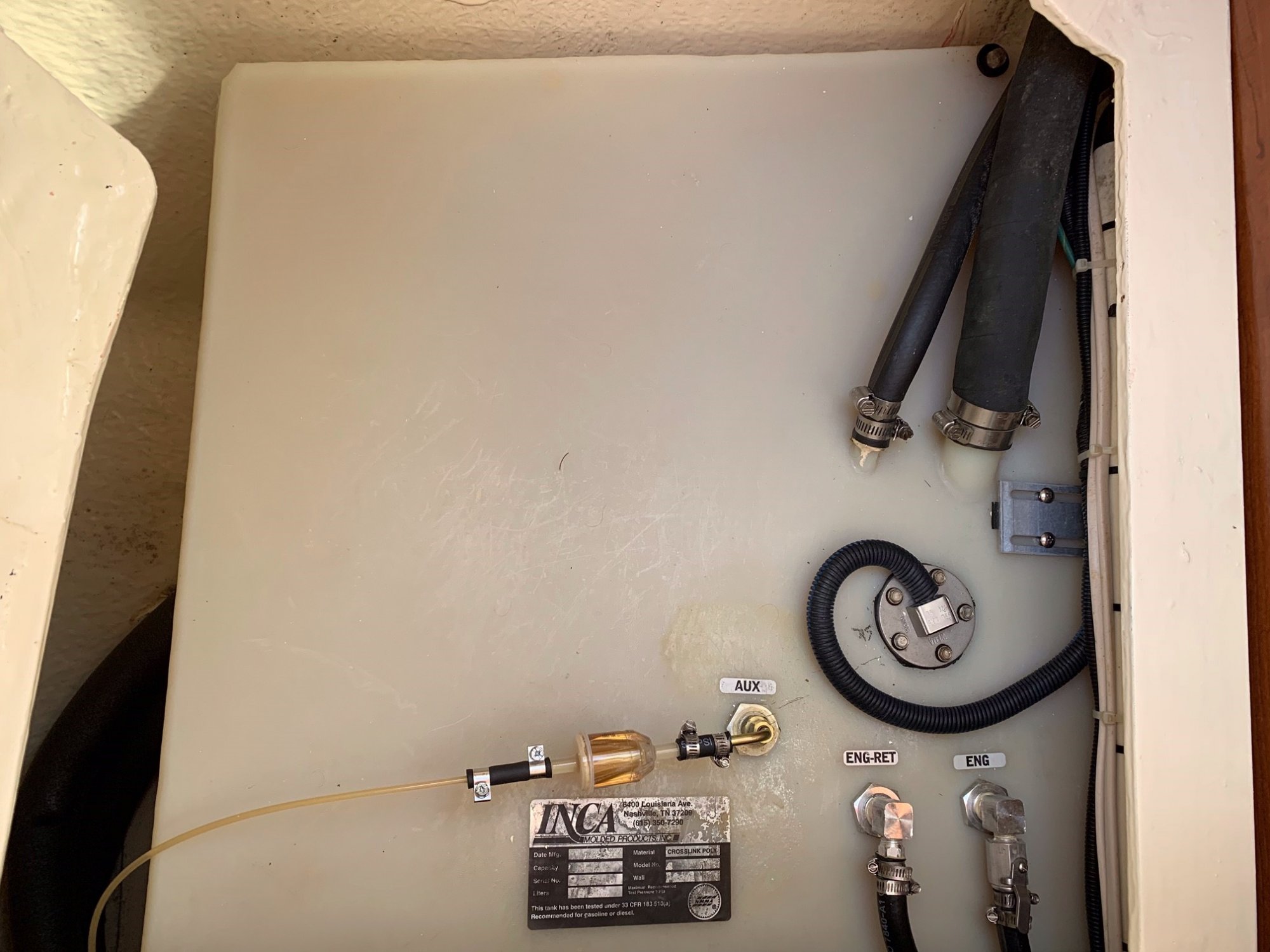

I’ve always had a problem filling my diesel tank full . The boat is a 2014 Marlow-Hunter 37 and at a certain point in the filling process the tank ‘burps’ and fuel will exit the fill hole. Recently I’ve taken to using an external 5 gallon can and a siphon, first filling the can and then siphoning into the tank. After successfully putting about 17 gallons in via siphoning, the tank burped again. I wondered if the tank was full so, rather than trust the gauge, I pulled the sensor out of the tank and manually measured the fuel level with a wooden dowel. I realize this won’t yield the number of gallons directly since the tank is not a regular shape. With this method I confirm that the tank is not full. At the point where I sounded it, the tank is 13 inches deep and there is diesel up to 8 inches deep.
I figure the tank is not properly vented. When I was removing the sensor there was ‘air’ rushing out. Does anyone know where the vent is located? Here’s a picture of the tank and the model number.

That is caused by the fuel entering faster than the vent works. listen for the air pressure change and stop the filling. Remove the nozzle, this will allow almost instant neutralization of the pressure. Now start the top off...but slowly. You may get a few suggestions to install a larger vent hose. BUT, it all comes back to the size of the nipple atop the tank.

Looking at the first of your 2 pics of the tank, I would say that the top fitting with loom around the wires is the sending unit for the gauge. The two below are a toss up. Small lines, so vent and and maybe the return line. Could also be the pump suction and return. No sign of the tank feed. That should be inch and a half hose . The vent nipple will be at the top of the tank. The vent should have it's thru hull either high on the transom or close by on the after quarter. Locate and check this . Mud wasps like to build nests in it's ports. Total occlusion will place a vacuum on the tank and not let your engine run. A partial occlusion will allow the engine to run but will severely choke off the air balance needed when fueling up.
10,152
Yup.. the line to the left with the valve at the ell is probably the fuel out to the pump and the other probably the fuel return to the tank from injectors.. Vent and fill are hidden somewhere else..

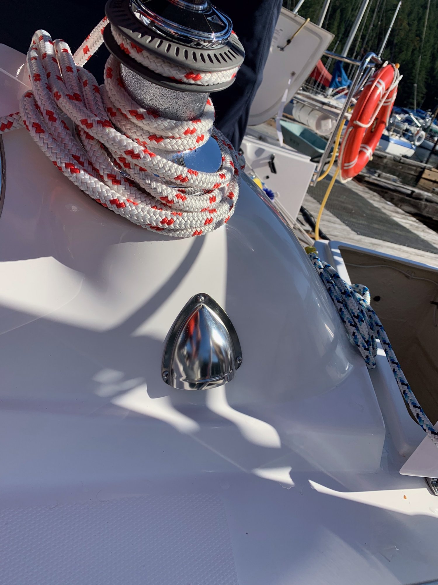

I notice that no other MH37 owner has jumped in to help and I am not sure if these pics will be of any assistance or not. Different year (2012), different model (e33) but maybe close enough to get you started. Have you have reached out to Marlow Hunter? Also INCA Plastics Molding maybe be of assistance.
INCA Plastics Molded Inc

If the exterior vent cap is with our screens, there is a good possibility that nesting insects have built a home in the line. I'd remove the line at the tank and slide a vacuum cleaner hose over it. Then run a wire fish or maybe start with a coat hanger down from the outside.. If you can't advance anything thru the transom cap you may need to remove the hose entirely. In any event once cleared replace the screen(s)
