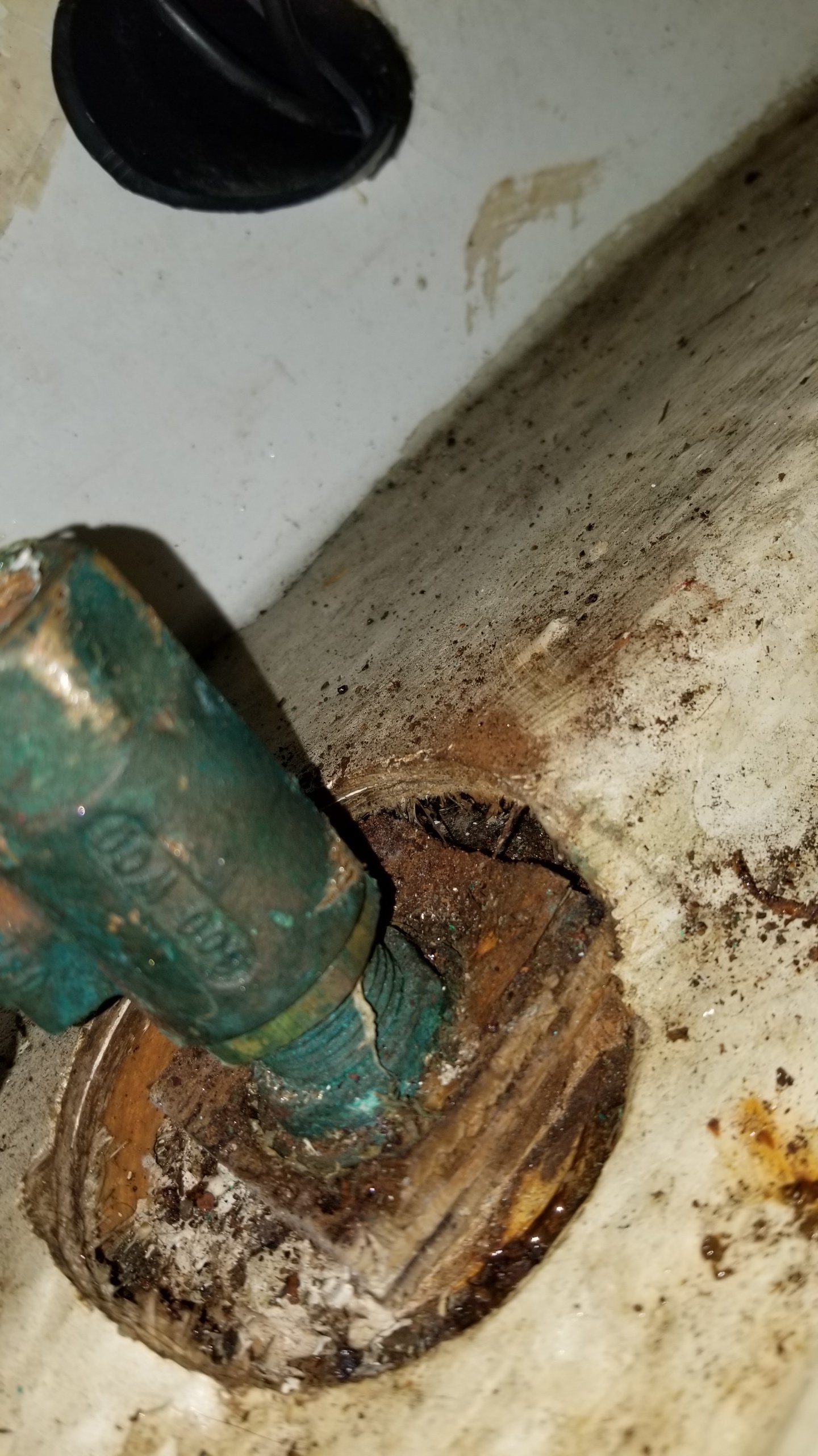

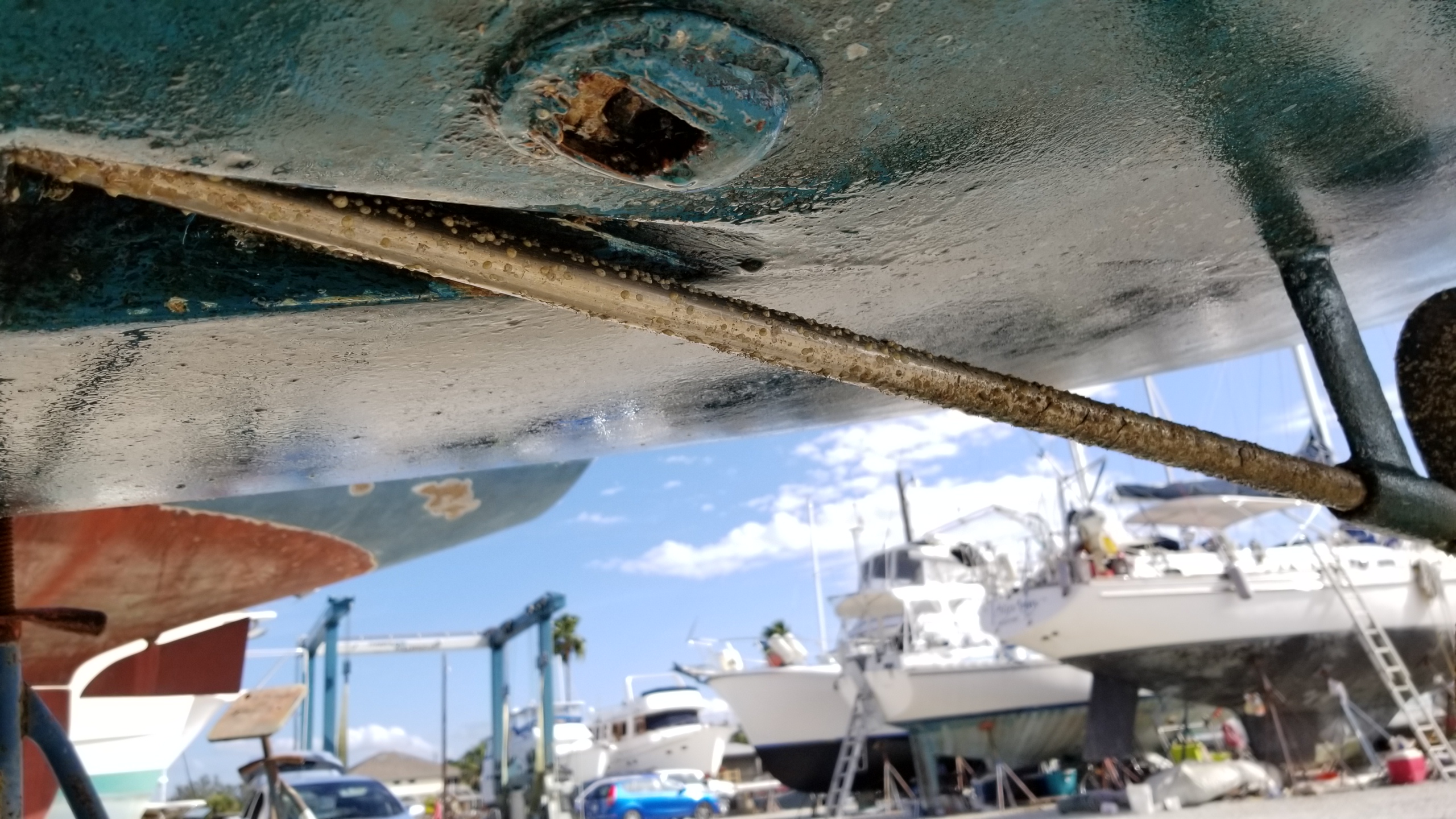

Just pulled the boat out to paint the bottom......again... and wanted to resolve my engine raw water thru hull valve issue. So, I tried to remove the 1/2" ball valve. It appears to be fused to the thru hull connector fitting. When I turn it, it turns the fitting. Tried multiple ways to hold the fitting in place... but to no avail..... Any suggestions on how to remove it? Maybe a chisel to the fitting from outside and try to remove the flange? Note that on the picture, the mostly disintegrated slotted cover plate has been removed.
Should I replace this with Marelon?
Thanks.. Jon

If the thru hull is turning, I'd replace the whole thing.. thru-hull, valve, and the wood backing plate.. Mine had been changed to Marelon when PO changed all the gate valves to ball valves, over thirty years ago. Still works fine but I am very careful to not stress it in any way.. The newer Marelon fittings are stronger than the old stuff.. I think they are fine for our boats that stay in the water all year long.
Jan 24, 2017
671
Hunter 34 Toms River Nj
I'm assuming that you plan to replace the valve and thruhull.
I would used a sawzall and cut the thruhull lock nut off at the backing plate base. Then use a flat head screwdriver as a punch and a hammer to punch out the rest of the fitting thru the hull.
You may have to loosen the fitting a bit from the outside if it was bedded with 5200 sealant.
It looks fairly old so it's most likely just caulk.
If you replace to ball valve you may want to used plastic marelon type instead of the bronze. Better to combat electrolysis issues.
Good luck.

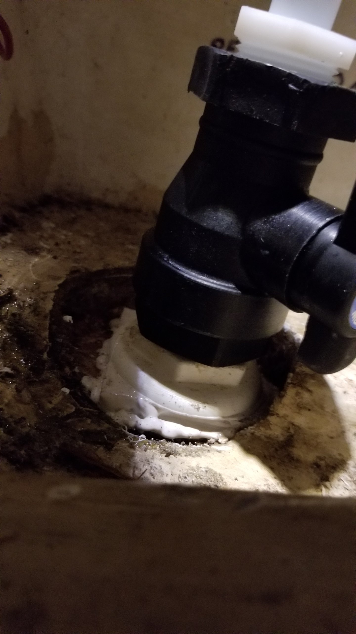

I ordered the
scoop strainer: http://www.forespar.com/products/boat-marine-plumbing-mushroom-scoop-strainer-thru-hull.shtml
and the ball valve... http://www.forespar.com/products/boat-marine-plumbing-ball-valve-thru-hull.shtml
After reading Allan's write up on positioning the thru-hull, I may have have to rethink my order and consider ordering a separate thru-hull and a stand alone strainer....

I don't think you want a strainer. It will restrict flow when its clear and really restrict flow when it is plugged. Inside the boat, use a straight tail piece instead of an elbow. If there is a clog, you can pull the hose, wrap your hand around it and clear it with a long screwdriver. Hasn't happened any more since I upgraded to the 3/4" thru hull.

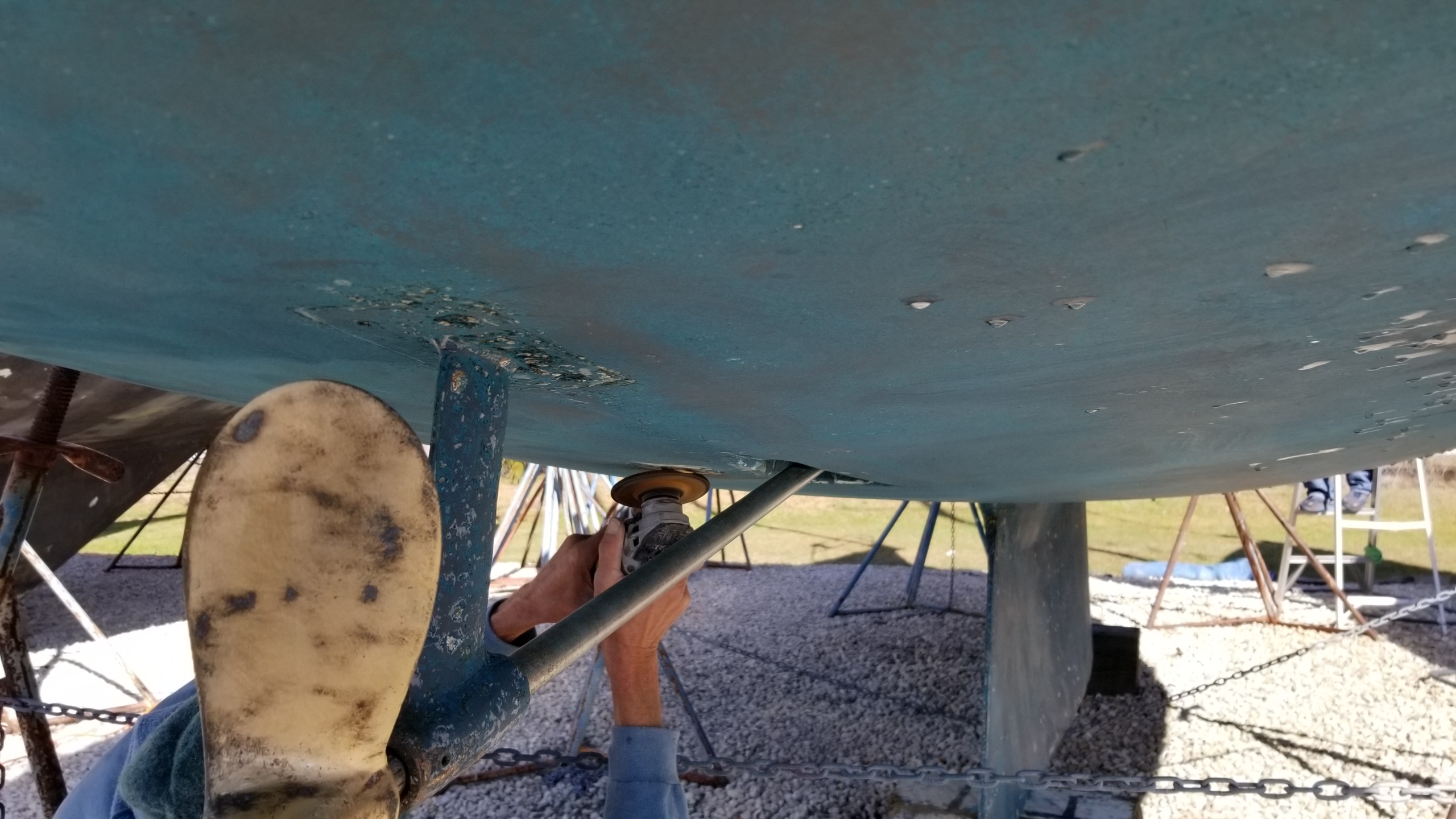

I was unable to loosen the thruhull enough to get a sawzall between the hull and the flange so we ended up using a grinder with a stone to remove the flange of the thruhull. Took about 4 minutes. Thank you all for the advice and examples expecially Allan and I could not have done this without SteveB's helping hands and advice! Thanks Steve. Now I just have to clean this up!
