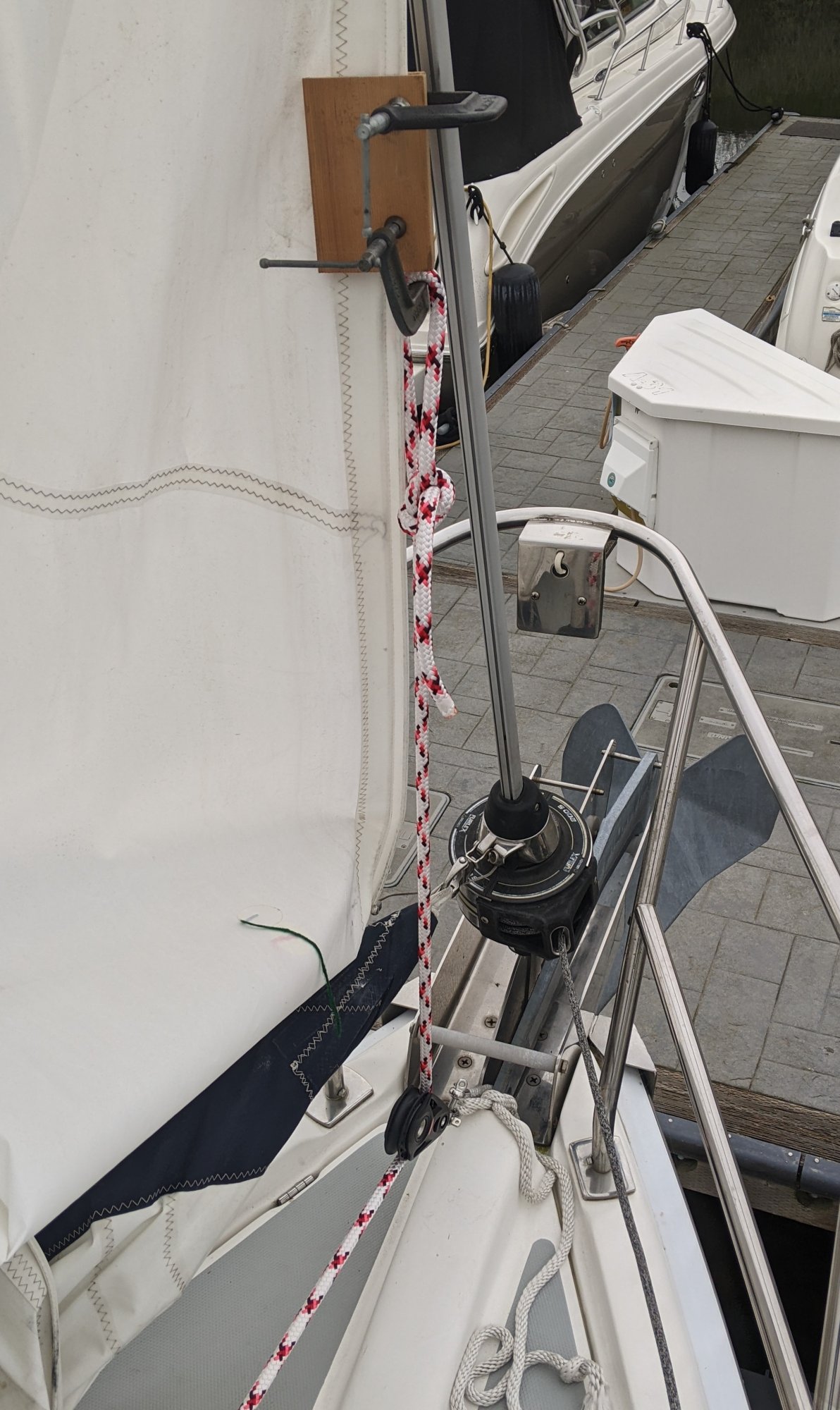

I was able to get the genoa down, finally. I used two blocks of wood and two C clamps to get a good grip on the sail and bolt rope, routed a line through a turning block tied to the bow/anchor and back to the cockpit to a winch. I had to reset the wood block/clamp assembly several times but the last 10 feet or so came down just by pulling sail. The photo attached shows the makeshift gripper.
I did inspect the extrusion using binoculars and didn't see anything that looked to be a problem. I'll try hoisting it again with the help of an assistant and some dry lubricant.

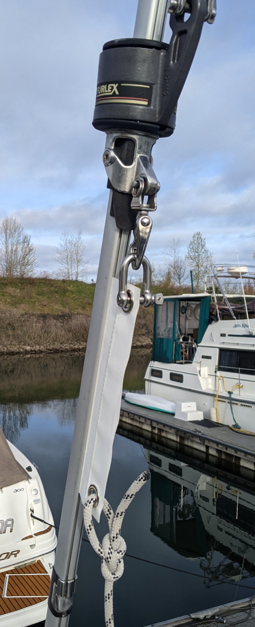

The attached photo shows the scrap of bolt rope that the sail loft gave me. Happily, it hoisted all the way to the top quite easily and came back down equally easily. When I get the head sail back from the loft I'll raise it with an assistant. I suspect that it will go OK.
23,931
Your tests appear to be successful. Anything is possible. I have seen jib sheets look fair but be wrapped near the top of a hoist and screw up the jib hoist. Wait till you play with a spinnaker... :biggrin:
It was something. You may never know waht. Just get the sail back, and with your helper attempt the hoist again.
Crossed fingers that all goes without incident and put it in the WIN column. Moving forward, there are plenty more exciting events to occur in your sailing future.
