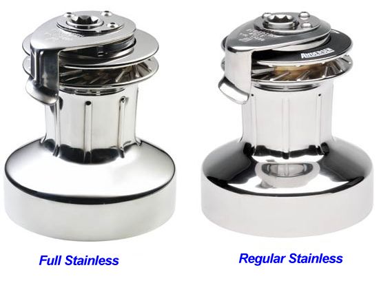

In 2013, I removed (and re-sold!) the Barlow 25 ST winches that came with my O'day 35. They were not gripping the jib sheets well, the chrome was pitted, and spares unavailable.
I replaced them with a pair of Andersen 40 FST (Full Stainless Self Tailing winches). The Andersen winches have a smaller footprint than the Barlows. I drilled out the holes were the Barlows were mounted and filled the holes with epoxy. The deck where the winches is mounted is cored with plywood. I then drilled new holes to match the Andersen bolt pattern, widened each hole below the skin with a Dremel and a Dremel 115 bit, filled the holes with epoxy, and re-drilled and chamfered each of the new holes. I backed each bolt hole with a large stainless steel washer, and used butyl tape to bed the winch on the deck. I did not use a new winch pad, nor do I think one is necessary. Realize that it will change the angle of the sheet to the drum.
The new winches are a VAST improvement in terms of leverage and appearance from the old winches.
I would upload a picture of the old winches, but the pictures are too large for the server to process. Here is a picture of the new Andersen 40s
