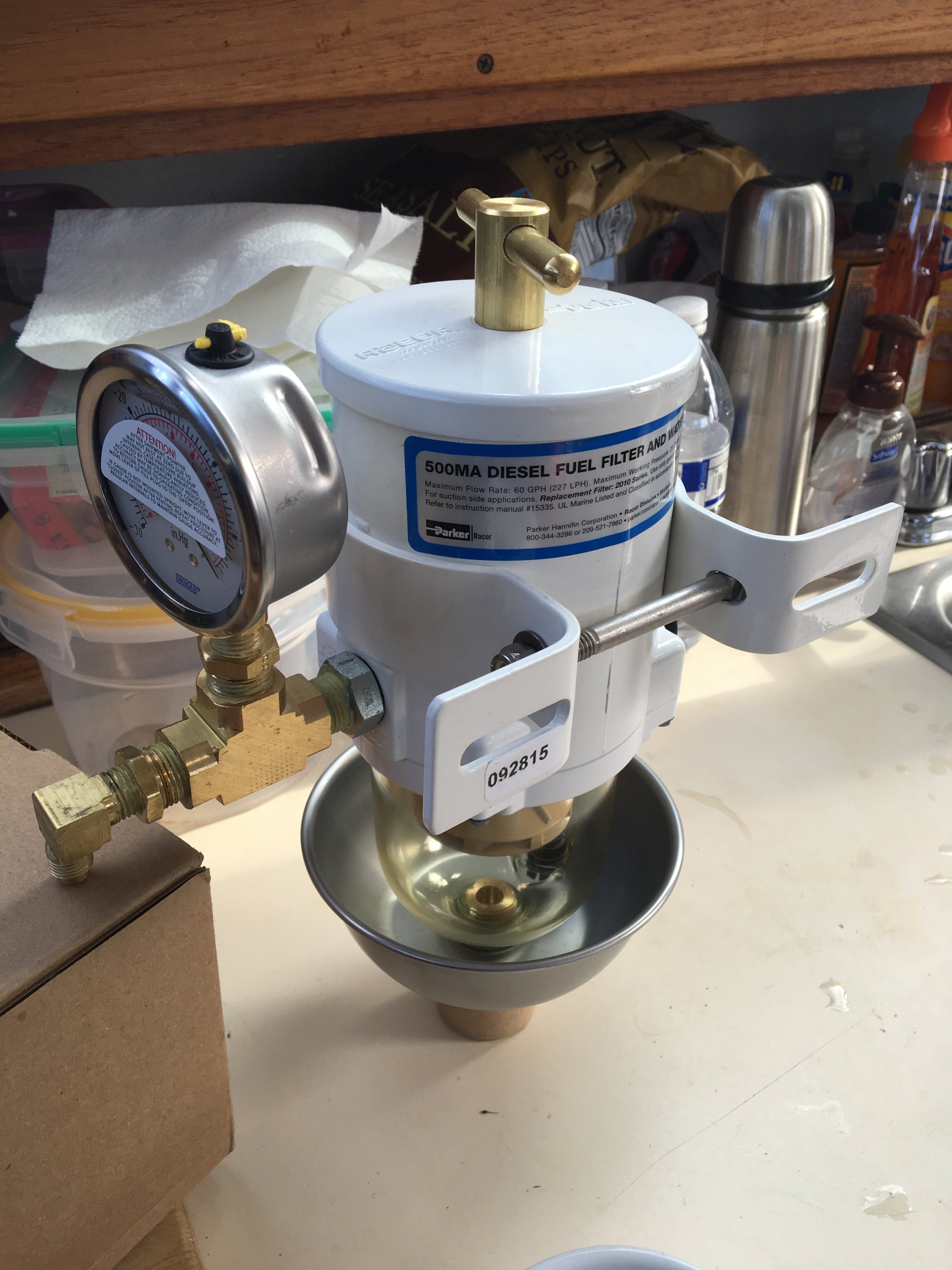

:plus: for the Racor 500M...
IMG_0786.JPG With vacuum gage

24,760

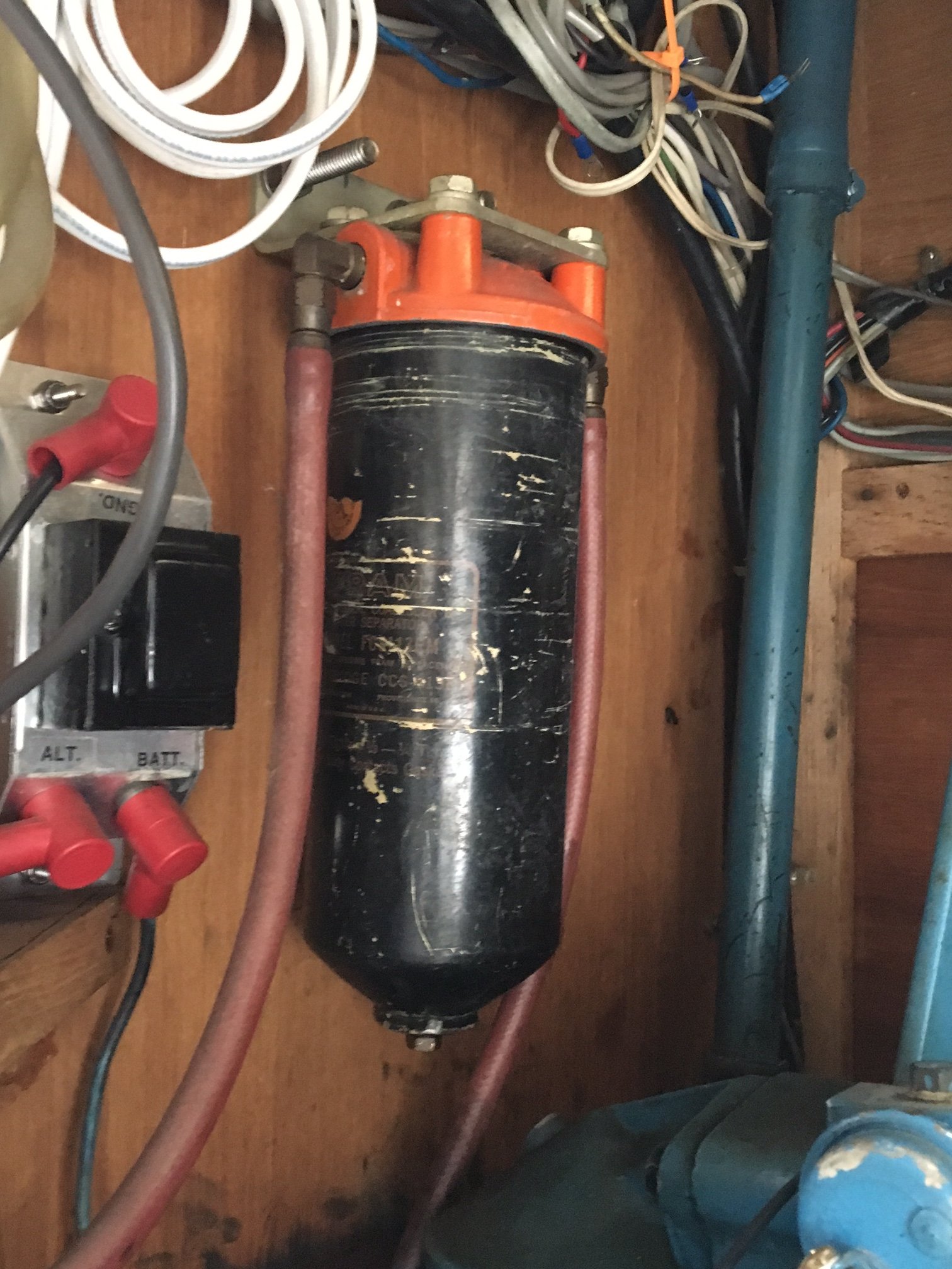

Your point is well stated. Convenience in changing filters, and information as to the condition of the fuel were keys in my change.
Here is what got dumped...
