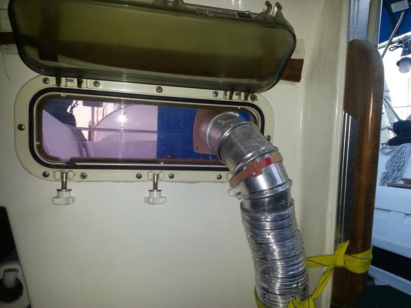

Stop all water ingress, liquid and vapor.. dry the bilge.. close off the scoops just forward of the companionway... THEN put the dehumidifier in..use a 30 pint capacity unit, or thereabouts.. circulate the air with small fans .. I have two of these that run pretty much continuously; one in the vee, one in the aft cabin.
http://www.walmart.com/ip/QV-Tools-Table-Fan/39889207
I have done this for over 20 years on my 34 here in South Louisiana..
I used to have a big dehumidifier that I secured on the counter so it would drain into the sink.. now I use the air conditioner set on its "dehumidify" cycle.

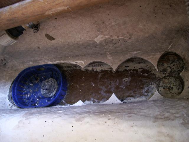

* Cut the bottom out of the bilge sump area to expose the gap between the inner liner and the actual hull. This allows you to mount the bilge pump on the bottom and evacuate stinky water that accumulates. Always use a sponge and soak up the remaining water in the bilge and under the shower sump before you leave.

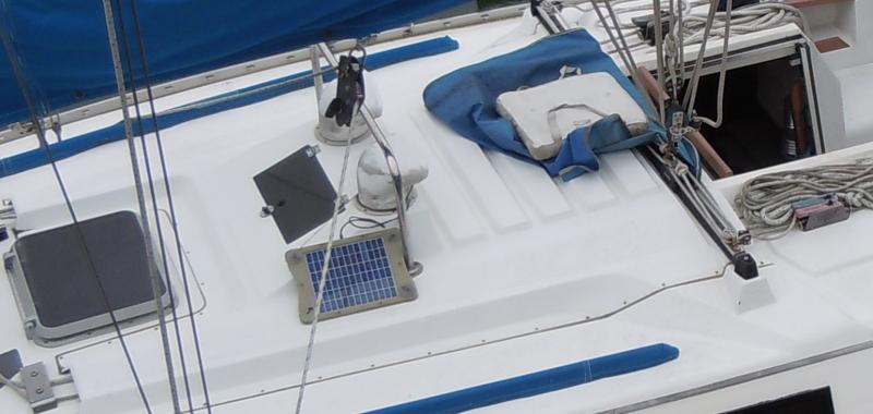

* I bought a 12 volt computer fan at an electronics store in Milpitas for $4.00 and put it inside the wood panel under the dorade vents in the main salon. I bought a 5 watt solar panel and put it in front of the dorade vents topside. Fish the wire in one of the vents and hook it to the fan. Now it runs whenever the sun is out. Face the dorade vents back.
* I bought a second fan and stuck it in the Beckson port down by the engine where you reach through to check the oil. That one I wired directly to the back of the battery selector switch. Since we leave our boat plugged in to shore power all the time, the fan stays on always as well. I put some dryer vent hose on the Beckson port and exhaust it out the port hole directly above. This one I am going to improve shortly.

I check the stuffing box pretty regularly. No sign of leakage yet. I have been considering removing the false bilge as you have done. This is a common mod for this boat. You used a hole saw which looks ideal. So, is there enough space under the false bilge so that the drill bit does not punch through the lower bilge?
1,667
Hunter 34 Alameda CA
Right underneath the fiberglass is a 1/2 inch thick piece of plywood which is going to be nice and rotten. Then there is another 1/4" gap. Are you familiar with the vibrating multitools? They didn't have them when I did mine, hence the 4" hole saw. Harbor Freight has the multitool for about $29.00. Get 3 or 4 of the half round blades and it should cut out in one piece. The hull thickness underneath is 1-3/8" thick so you can fasten your bilge pump with some real short screws.
