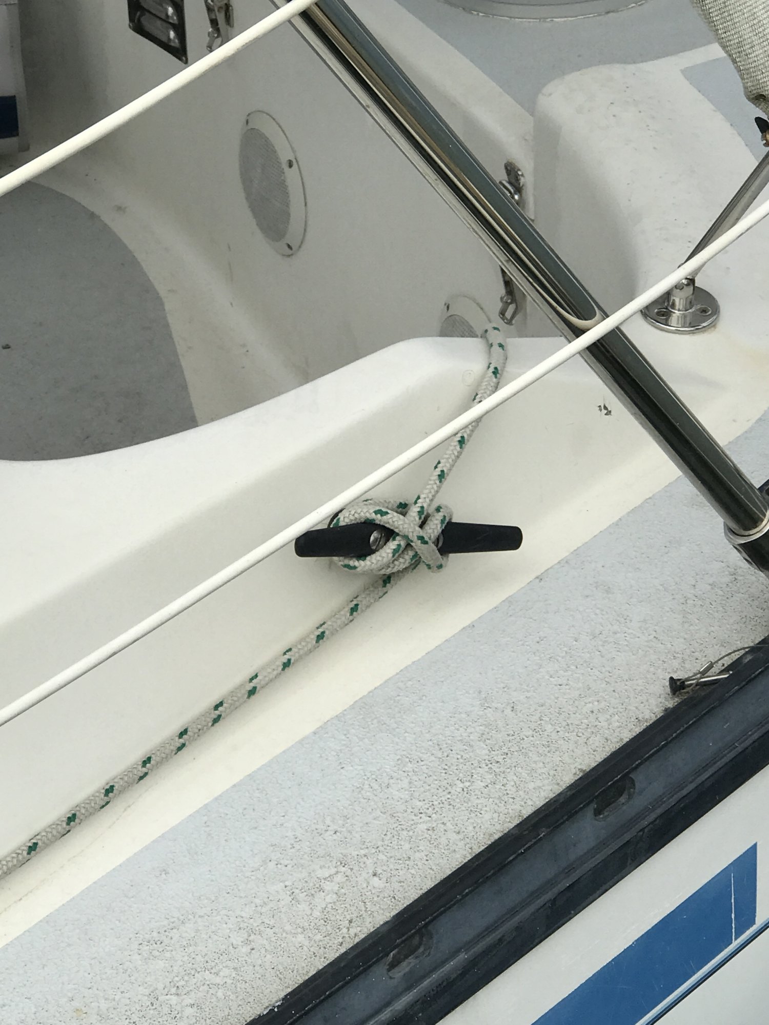

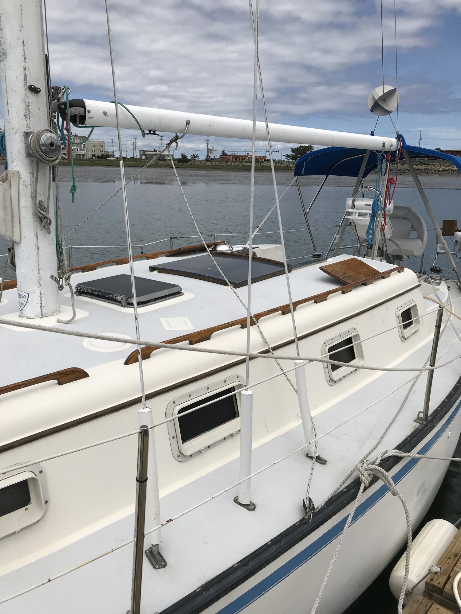

Stephen, my preventer photos are below. Presently the connection at the boom is on the old vang loop. I would prefer to have that connection closer to the boom center. In the past I ran a line between the vang loop and the mainsheet loop with the preventer attached near the center but have done away with that this season. We will see.

My boom only has the two bails, one for the preventer and one for the mainsheet. In prior seasons to get an attachment for the preventer closer to the center of the boom I have tried two other arrangements. One was a line run between the two bails with a connection loop for the preventer near the center. This spread the load over the entire boom but was messy. The other was simpler and consisted of a line run from the mainsheet bail, along the boom to about the center and then a wrap around the boom followed by the preventer attachment. That worked well. This season I am trying just using the original vang bail. The vang is no longer needed as the preventer performs that duty pretty well. We will see. As for shock loads, once the preventer is rigged and tensioned shock loads are minimized. Without a preventer shock loads on the mainsheet are a real threat with a surprise jibe. BTW, I am unlikely to be sailing in wild seas like those shown above and be worried about my boom striking the water.

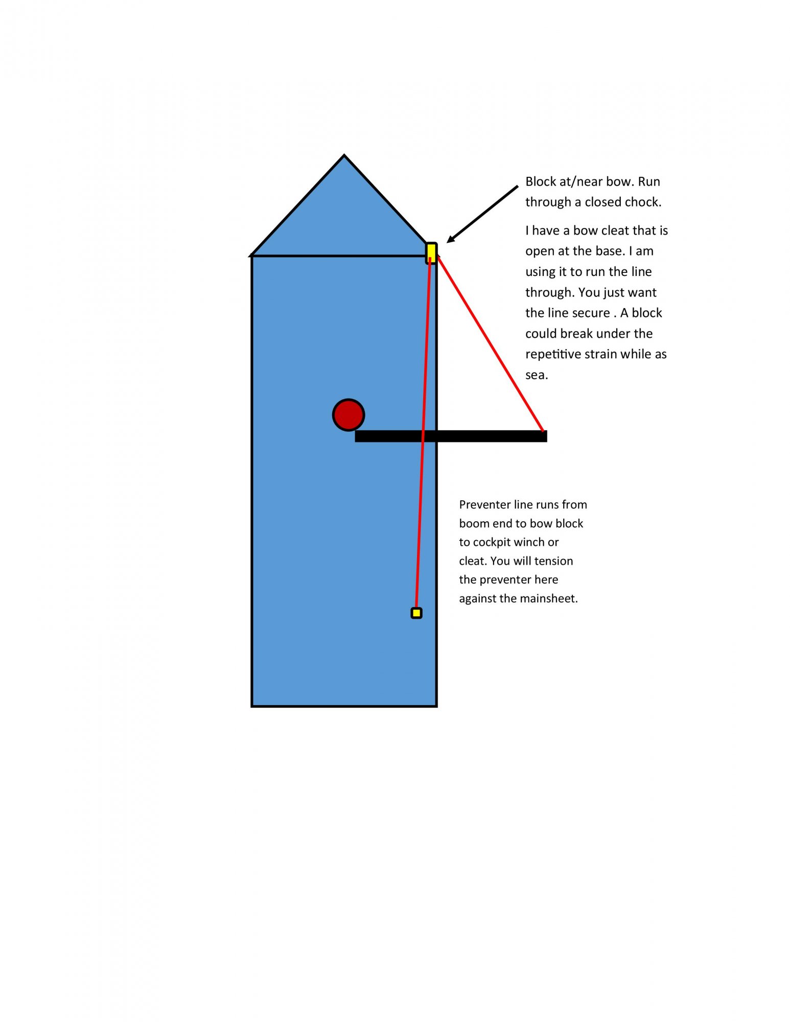

The simplest rigging is to tie a nylon double braided line to the end of the boom, run the line up to the bow (outside of all stays and in a manner that it does not conflict with the jib sheets). Attach a block to a hard point at the bow. I use a soft shackle through the block and attached to a bow cleat. The line is then returned to the cockpit where it is secured. You can use a cleat or a cam cleat also works.
Adjustment of the preventer is to pull it so the boom moves out and forward. The mainsheet is used to balance this forward movement. WIth both lines tought, the boom is captured in a single place and will stay there till you trim it differently.
To gybe, you release the preventer and pull in the main. Note you will need to switch the preventer to the opposite side of the boat on the new tack in the same way you set it before. The preventer pulls the boom forward and the main sheet pulls it aft.
