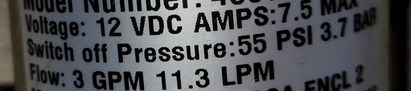

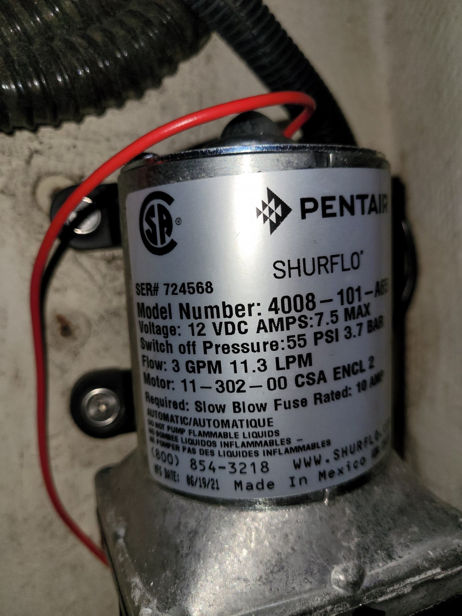

I just installed a new Shurflo Aqua King II pump.
Even with the old pump I didn’t experience issues when the heater went from cold to hot. I do have a check valve that prevents the higher pressure in the heater from pushing hot water back into the cold water inlet side. So I don’t understand how pressure in the heater would affect the pump pressure.
Anyhow
The new one does not cycle on and off due to pressure build up during low flow rates.
The manual says it has a by pass valve that bleeds off the pressure under certain conditions that works with the on off pressure switch to prevent cycling on off while maintaining pressure.
It appears to eliminate the need for an accumulator to stop on off cycling.
Works very well for my use.

I also have a Shuffle Aqua King, it one cycles when there is a leak in the plumbing system. Otherwise it comes on when a tap is opened and shuts when it is turned off.
A check valve in the HW inlet prevents back flow.
