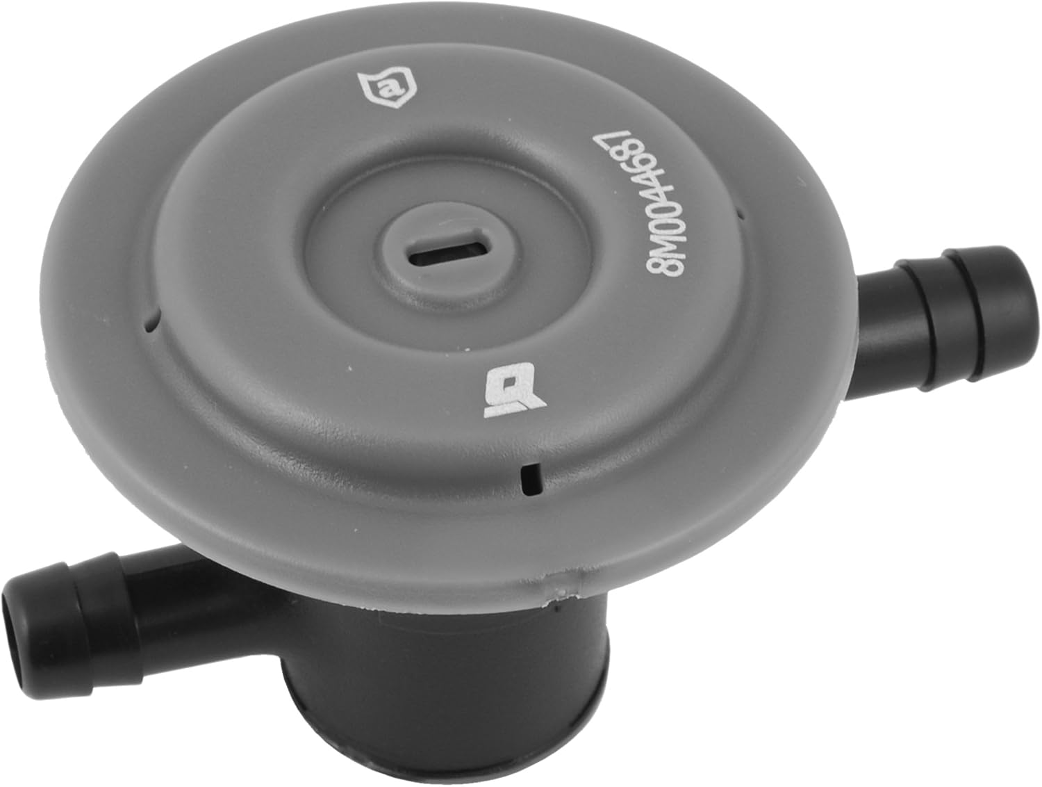

b. You can install a demand valve on the tank (see below). These are required in new installations. A simple cut-off valve also works. But not the problem.

Demand Valve
The OP said "No vent. I'll make sure to crack the fill tube and let out any pressure next weekend when we go out and see how it works."
Obviously, portable tanks are ALWAYS vented in use. Maybe you misspoke. If the tanks build vacuum that will make the motor cut out and not restart.
