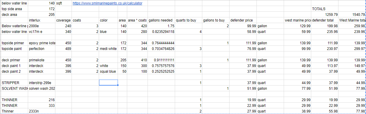

With that said here is where i landed:
using the calculator https://www.smlmarinepaints.co.uk/calculator here and comparing against the west marine and interlux "suggested quarts" for bottom paint as my base line (my findings actually call for an extra quart than theirs) this is where i landed.
interlux 2000e barrier under the water line with vc17m extra over that.
Primekote primer elsewhere
perfection for the freeboard, interdeck for the deck. standing areas to be painted in blue, otherwise everything is white.
Plus strippers/cleaners to prep surfaces, as well as the thinners to get first coats down as well as tool cleanup.
I plan on buying a 5 dollar roller for each paint per coat just to save on the thinner cost to clean up. I'll buy a couple tipping brushes from defender and will plan on cleaning those between coats.
right now the plan is to strip the unknown bottom coat, then use the surface prep after wash to clean up. The rest of the boat the surfaces will be roughed and then coated with primekote to prep the paint. any deep gouges or fairing areas that need to be fixed will be (doing that currently and into the next week or so). and then off to the races to get it all painted. thankfully i have a couple folks onboard for helping me getting surface prep done and my dad and another friend who's painted boats before on hand for the actual application.
I'm stinging a little, 1200 minimum, closer to 1500 probably when all the bits are bought and an emergency run to west marine or two for more thinner or god knows what. i paid 2 grand for the boat
but its within budget so enh. price to pay the piper to play. If anyone sees anything i blatantly missed or messed up please please let me know
