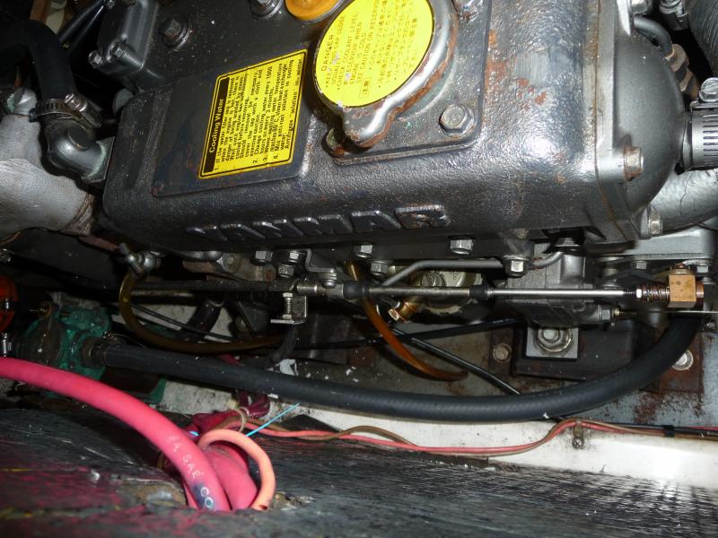

H-34 Bilge Pump
Ya welcome, Phil..
On mine, the bilge pump is hooked up "hot" to the #1 Batt terminal on the "Off, #1, Both, #2" batt switch .(not switched, always hot) . That is the wire that powers it through the float switch in the bilge. In this picture, you can see the red/brown pair from the pump coming the switch in the engine box. Make sure ya put a proper fuse in the hot line where it leaves the batt switch. There is another bilge pump switch on the 12V panel that bypasses the float switch and turns the pump on. This one is powered from the 12V buss behind the panel which is powered from the switched side of the battery switch.
