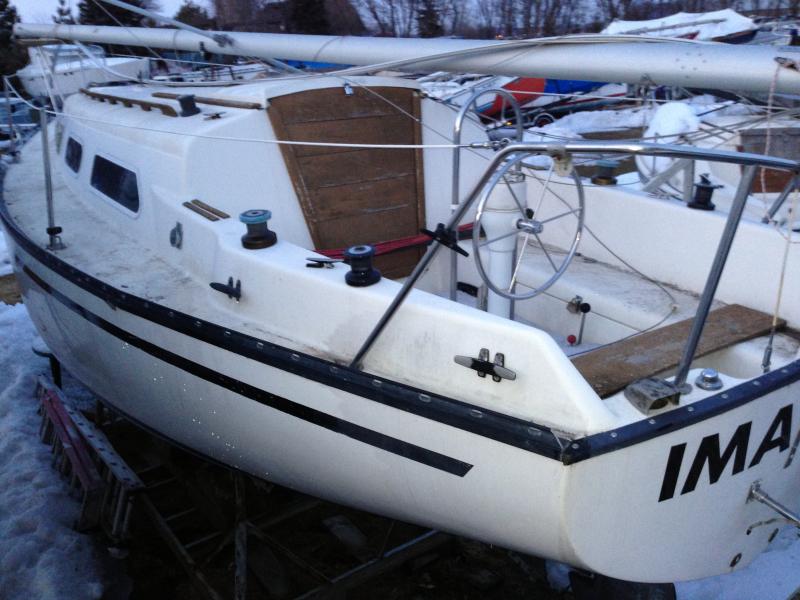

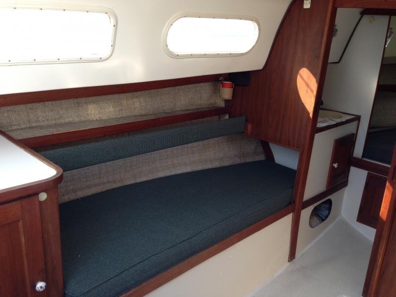

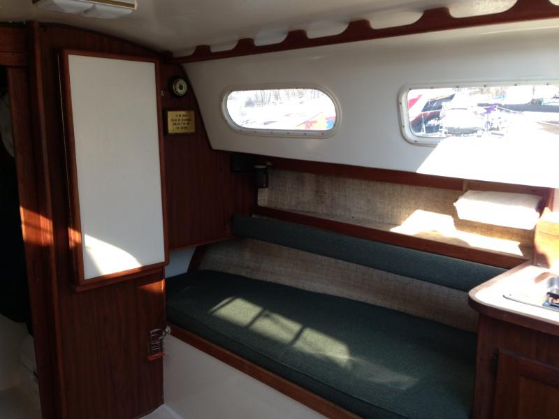

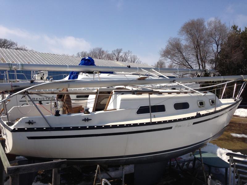

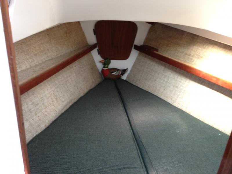

Hi, I'm new to SBO and sailing in general. I've made / the original owner (that's right, 1 owner for a 35 year old boat) has accepted an offer on a 1978 27, pending the outcome of a survey. I've been inside the boat and in general, she looks pretty clean. There are a couple fairly substantial areas of wall fabric delamination (v berth and rear quarter berth are most significant), and the pan under the yanmar diesel is full of ice, as is the cockpit floor (ice in cockpit is about a foot thick, so I can't yet get it out) and bilge. The ice is (finally!!) melting in MN, so it is running onto the salon floor. Since the bilge is also full and frozen, I've been wet vaccuming it. The salon smells musty...
The ports and the hatch were slightly loose, so I tightened them down. I wonder if the fabric delam is due to loosening of the deck and hull bolts, or just maybe a consequence of moisture intrusion from the hatch and ports? Of course, there is no opening port over rear quarter berth, so maybe it's not that simple. If it is a combo of port leaks and deck bolt loosening, where are these bolts and how to I tighten them? Also, is it normal, given the lack of covering over the cockpit and deck, for water to leak in like this during winter?
Last, the motor also has a small pan under the oil pan, and there is maybe a half cup of oil in it. I don't see any signs of oil seepage around the top of the pan - it might be coming from the plug? Just curious if I should be concerned or not. It has been on the hard for at least one year, maybe longer. Current owner says she runs perfectly and I have no reason to doubt him. He's an older guy and isn't pushing the boat on me at all. I doubt it's a big deal, but y'all know better than me!
To me, she looks great, just in need what I perceive to be some general sprucing up.
Any thoughts / ideas from your sailing experts are very welcome! Thanks in advance.

The survey is an excellent plan and will tell you far more than we could. Water can come in through the hatch dagger boards, windows, lots of places. Might have a leak at the base of the mast where the wires come through the deck.
There usually isn't a drain plug on these engines. Oil has to be sucked out through the dipstick pipe. Oil in the pan would indicate a leak somewhere and you'd have to trace it out, assuming it isn't a spill from draining or filling the engine.
Deck/hull boats are not usually a problem on these Cherubini Hunters. Probably just from humidity from having water in the people tank. Hope the survey comes out well. These are great boats. Post pictures!

Don't have the survey done until AFTER the ice has completely melted. Lots of major problems could result from ice in all the places you mention.
Also, oil leaks on a marine engine are not normal and any problems can only be identified after the boat is back in the water and run hard. If you intend to close before then, insist on a hold-back pending successful engine performance test.
Don't let the cosmetic appearance of such things as headliner cloud consideration of engine and structural problems which even the previous owner may not be aware of if the boat has sat a while

Thanks, guys. I hear you re: survey AFTER she is fully thawed - the surveyor told me the same, so we'll do that later in April... I really hope she checks out okay.
I will have the engine thoroughly examined as well. Hopefully it's just a gasket and can be replaced w/o major effort.
I was able to get all ice out of the cockpit - there were leaves and other debris plugging the drain ports. Once cleared she drained nicely. Also got the ice cake out from under the motor and was able to clear a lot of the ice out of the bilge. Forward hatch and opening ports will all probably be replaced later this spring.
It was super fun just puttering on her today. This was only our second 50 degree, sunny day this spring. The sign of better things to come.
I took some nice pictures, and will post a few once I transfer them to Photobucket.

You mentioned wall fabric delamination. I believe on your boat, there was carpeting that was glued to the hull for insulation and soundproofing. My H27 has strips of teak along the hull in the V berth and along the sides of the hull over the settee backs. Is the delamination only the carpet glue letting loose, or is it actual fiberglass delamination? I find it hard to believe it is fiberglass problems. If you wanted to replace the carpeting, that should be fairly easy to do.

I talked with the Surveyor before he did the evaluation. I explained the issues I had noticed - leak into engine compantment thru the starboard lazarette, leaky ports (mainly port side, where there are 3 opening ports), leaky and "shaky" trapexoid hatch sliding arm, engine oil leak, movement in prop shaft, brown "goopy" leaks the appear on chart table and galley counter top and terrible mis-alignment on "bridge" piece that spans between the bulkheads. The teak span piece (broker calls it a "thwart"..?) between the main cabin and head that guides the pocket door is badly misalinged.
He asked about my skills and interest in fixing up a boat - I was honest and said I could do the cleaning and light maintenance, but did not have the time or skill to take on a "project boat". His advice was that I move on, mainly because of the number of leaks (I noticed another leak over the rear quarter berth that might be coming in from the deck or between the cabin and cockpit?) motor concerns, possible cutlass bearing or stuffing box issue, core rot potential (I guess the re-appearing brown goop is apparently dissolved, rotted core wood that leaks when new water comes in) and possible structural issue.
The broker looked at the bulkhead issue and suggested I fit a piece of teak into the space that exists between the ceiling and the "thwart". Not a fix of any sort that I'd be interested in. He said the area was damaged by the core around the mast rotting and sinking, which has been repaired by the PO. But, in my mind this "thwart" needs to be removed and re-set. He did not address any of my other concerns.
This boat has nice sails and nice cushions and the deck near the mast step has been professionally repaired ($5K according to the PO). The hull is generally clean, but could use a nice buff and wax. It has VC tar bottom that is in good shape.
But, I'm very wary of the rest, hence my connundrum... The boat is being offered to me at $3K, but in my opinion, will need maybe $2K of repairs. It will also cost me $4K to slip it, so I'm looking at $9K to start. Not sure if that's a good deal (for me) or not.

Run and don't look back. There are just to many good boats in this buyers market to settle for someones problems. If you wait until the season begins in earnest people will have paid for a seasonal slip and will likely throw it in with the purchase.But for now Run.

I'm with the surveyor - pass. Brown goop repairs can be done, but it's expensive if you can't DIY. The bitter taste of problems will remain long after the sweetness of low price is gone.

Agreed. I've notified the owner that I'm moving on.
