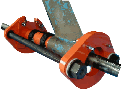

I also did not have luck pulling/pushing my bearing out..I cut it with a Dremel tool with a little sanding drum..and then it came out...see pic.
