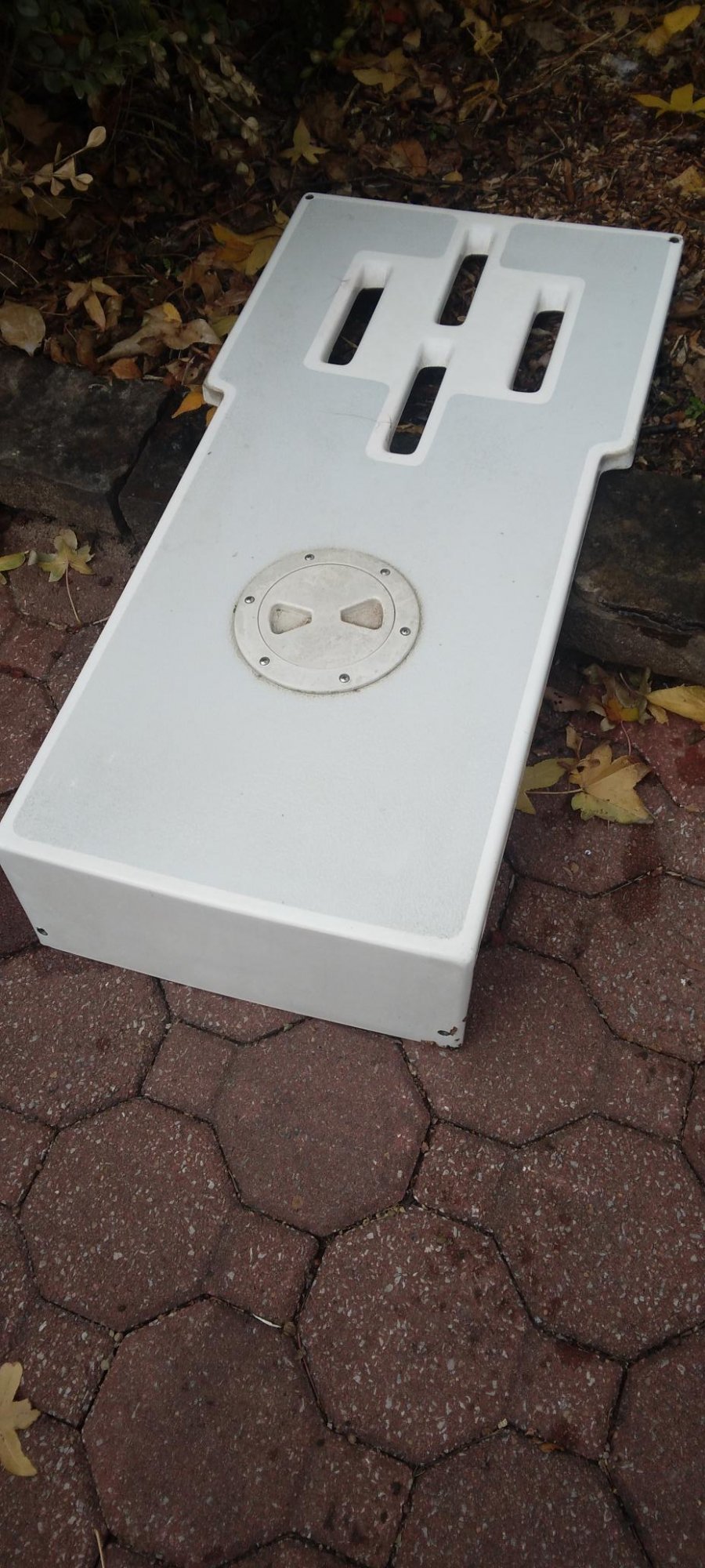

I was opening up the cockpit sole panel to unbolt the rudder. The space below the panel is full of leaves, muck and mud nests! Why would Hunter put these large slots in the panel? There is no where for water and debris to drain out. That downturned panel fits flush to the walkthru transom. What's the thinking here?
While I have the panel home, I'm contemplating some sort of stainless or plastic mesh epoxied to the underside to keep the big stuff out of the space underneath. Any thoughts on this?
The panel slots are right behind the pedestal. The steering quadrant is under that access panel. It's where the emergency tiller goes thru. The underside has flat rims around the slots I might be able to epoxy to.
