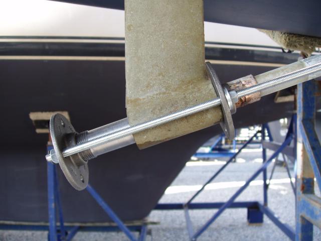

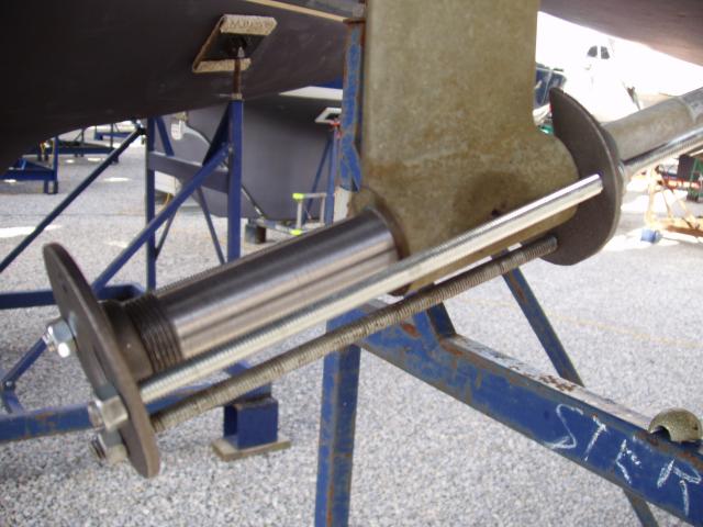

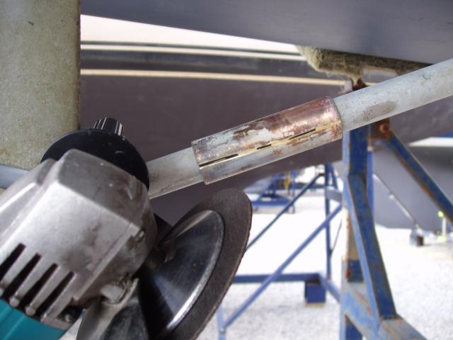

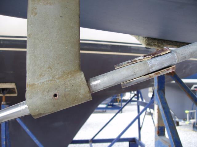

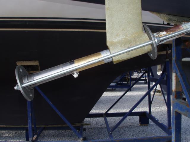

I just did it today. Took a total of two hours.
I made a tool using Home Depot parts using steel pipes, threaded rods and flanges. Most tool press it out the rear end. I push it in and then use a cutoff tool to slit it open for disposal.
Total cost; $80 for the bearing, $50 machine shop charge, $25 Home Depot parts. 2 hours of my time.
