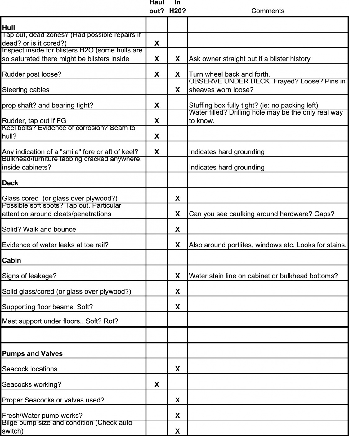

FWIW, I don't think it's a bad idea to have a quick cheat sheet on things to check when looking at a boat. Not a detailed survey guide but something slightly meatier than a checklist. I can see how that could be of use for new boat owners when looking at a boat pre-survey, or for someone buying an older 20-footer who might not hire a survey.

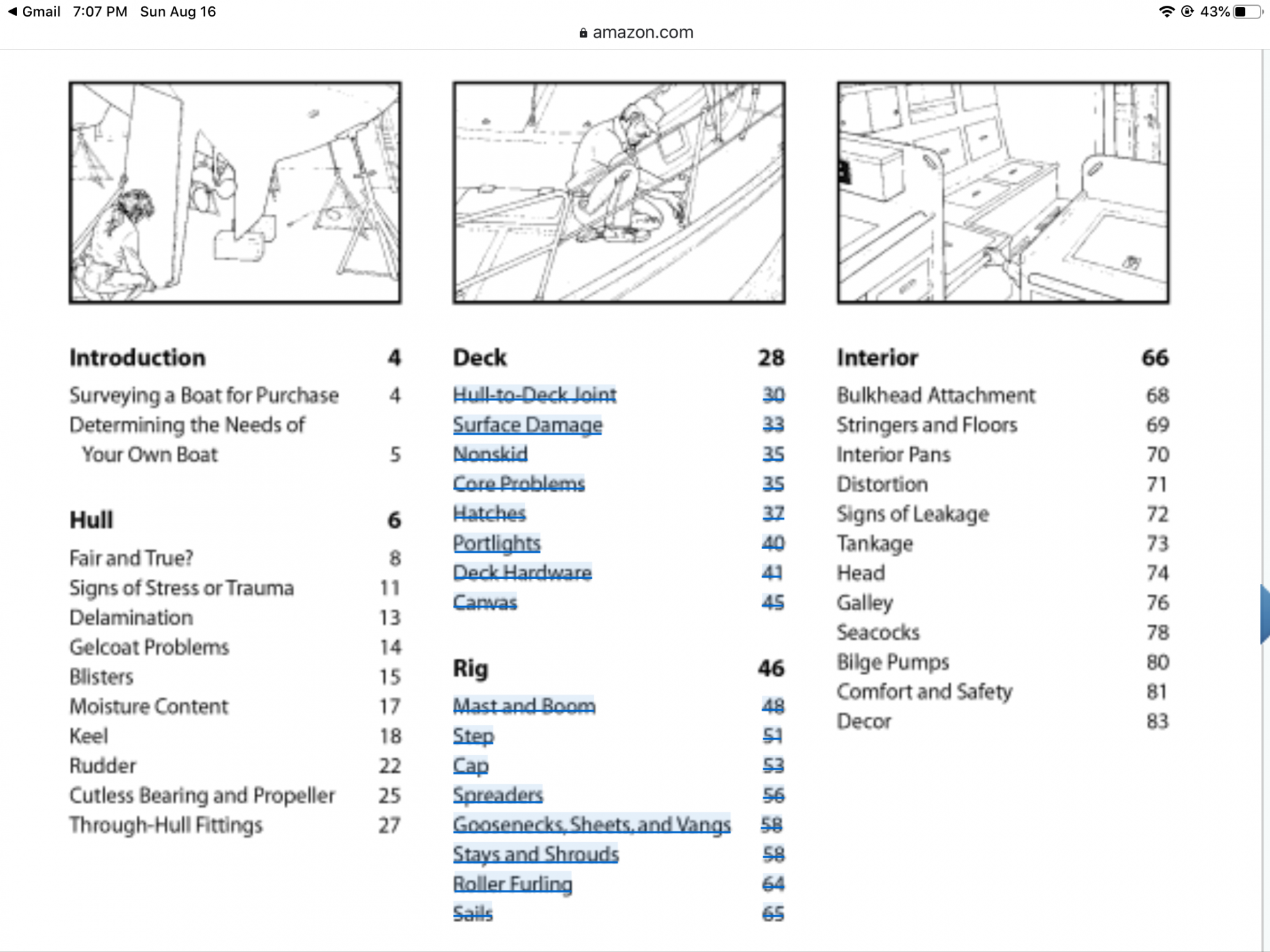

There are whole books written by experts who know how to do surveys. I’d suggest you read A book like Don Casey’s Inspecting the Aging Sailboat, to learnhow to evaluate what you,re seeing, and then create a checklist.
Here’s the table of contents From the book.
