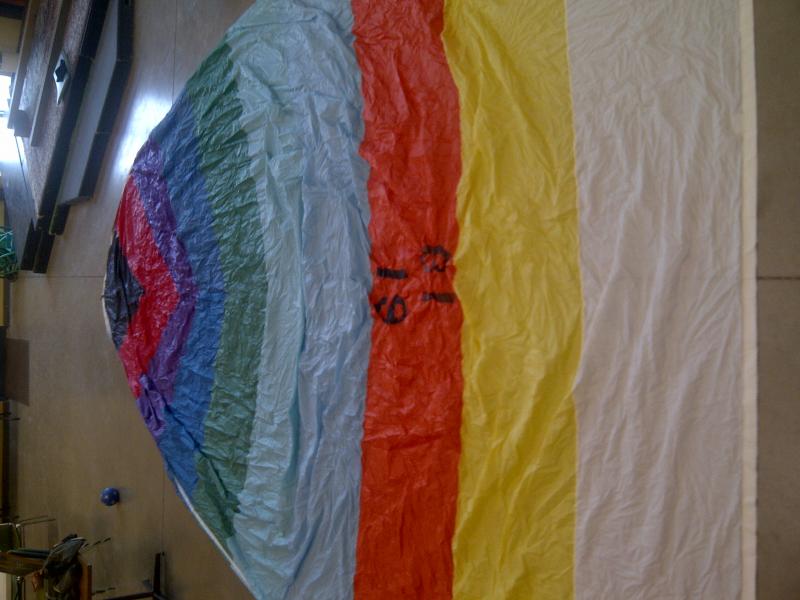

I just happen to have a couple symmetrical spinnakers. There off a HR 25. and are about 2.5' taller and 2' wider than what came with the S or D. (I think faster.)
Here are a couple pictures.
Check your PM inbox. Email me back and I can send detailed pictures of them if you are interested in trading. I could use a regular jib with luff tape on this new boat. The one I got from Kijiji is a 150.
