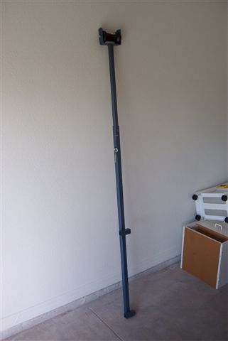

H23 mast crutch (the real deal)
Here's the mast crutch I mentioned earlier. It's made of two pieces of box-section steel telescoped inside each other. The whole thing is about 6 ft high closed and almost 11 ft high when open. The roller at the top makes it easy to move the lowered mast forward or aft. The two cross pieces near the lower end have holes that fit over the rudder pintles on the transom. With this crutch and the A-frame I can raise and lower the mast single-handed in about 15 minutes. Peter H23 "Raven"
