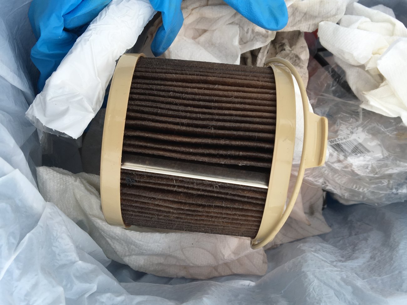

23,179
For those who enjoy pictures.
Here is what a dirty filter looks like when the engine shuts down from fuel starvation.
The vacuum gauge would be showing up somewhere in the plus ten range. The engine just starves for fuel. It races a bit maybe a surge then quits.
When it gets this bad you have to change the filter and prime the fuel lines as you will have sucked them dry.

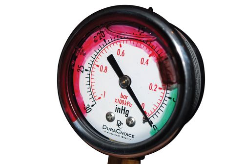

Mar 20, 2016
595
Beneteau 351 WYC Whitby
