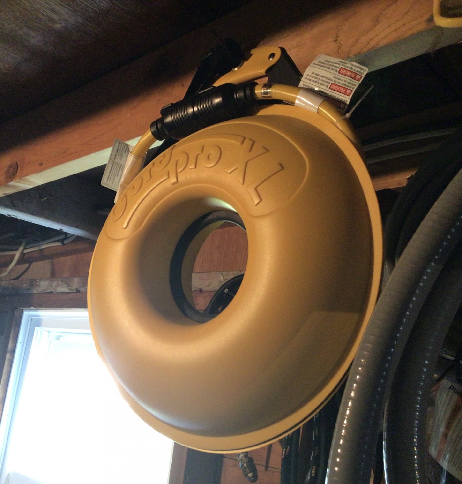

My boat is on a mooring, I don’t have this issue, but friends have used a product called “CordPro“ for their dock side power cords. They drain any water away and neatly store the cords allowing you to extend out only the amount you need to deal with raising and lowering of tides and dock movements.
I use them to store my portable home generator power cords. They really do work.
Take a look at them, may be something you could use.
