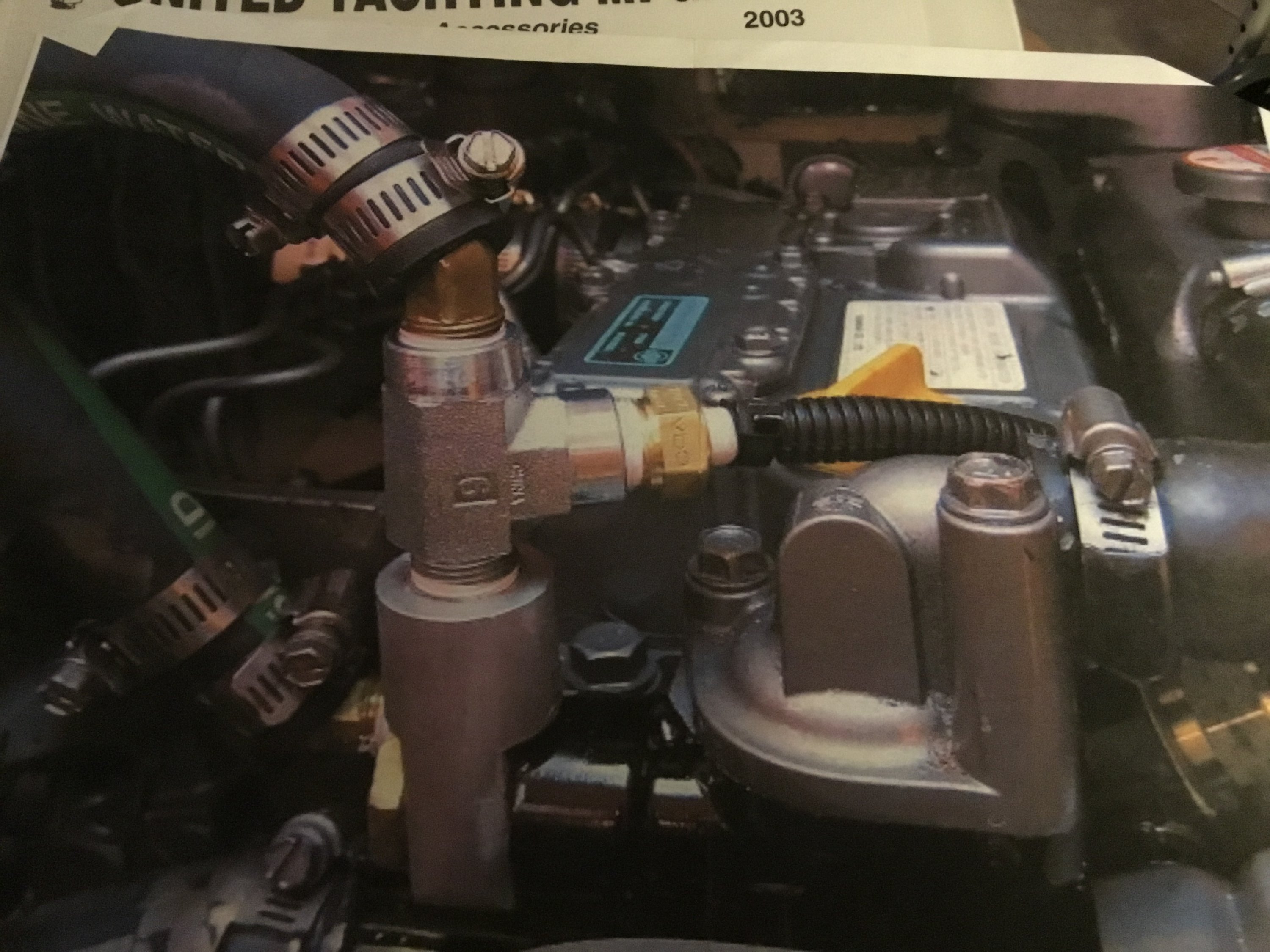

How much water coming out the exhaust take off front round cape on the front heat exchanger only uses O ring and look into heat exchanger holes and run round rod into each hole if looks dirty,also check hose from strainer to raw water pump and I just changed mine.
I added temp gauge into hose going into thermostat and really helps let me know how hot engine running and keep track what’s normal or not mine runs 180 and goes 190 when I push over 3000 rpm’s,I will be changing the antifreeze soon but I don’t really over heat.

The sensor was a little tricky and tried 2 until the right one worked
I think got the sensor from west marine or marine store to fit in brass tee and gauge all worked with good ground.
I just had back surgery and 4 days in hospital and can’t get around
too much but will look and see for a photo I have some place and I put gauge where key is and just right room and always can see from helm,best thing I ever added.

Thanks Nick. That's a nice installation. Was the bottom of the tee that fastens into the engine a 3/8 npt pipe thread or a metric thread? The parts manual seems to imply 3/8-in npt, but that seems odd on an otherwise metric engine.

I got the brass fitting at AC hardware and not sure what size but maybe 1/2/and took fittings with me to match up.
