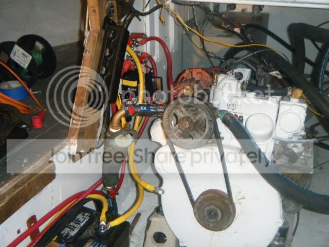

Hose was reinforced wire wound diesel exhaust hose. I'll post picture tomorrow. Any idea how to wash the dried salt residue off of the generator housing and auxiliaries? I'm thinking distilled water and a sponge.

Marc I already did this last year after about 400 hrs on the genset which as you know is the same as yours. The OEM hose is a pos imho. One day I noticed the stiffening wire was wearing through on the hose so I replaced it with a length of good quality exhaust hose. I would also recommend visually inspecting the FP more frequently. I remove the enclosure after about 20 hrs or so in between cruises or moves. There are certain things I always inspect such as the raw water pump, rear bearing sight glass, capacitors, belt, fuel filter, and that exhaust hose. A friend of mine who has the same genset actually had the metal exhaust pipe in this area wear through and begin leaking. Most of us also say a short prayer over the unit before we button it up. :)

had the same problems on my FP mini 8 a couple of years ago. OEM hose is poor quality. also had the mixing elbow fail. new one has almost twice the wall thickness of the old one. sprayed the genset down with corrosion X http://www.corrosionx.com/ and have had no issues with any type of corrosion since.
