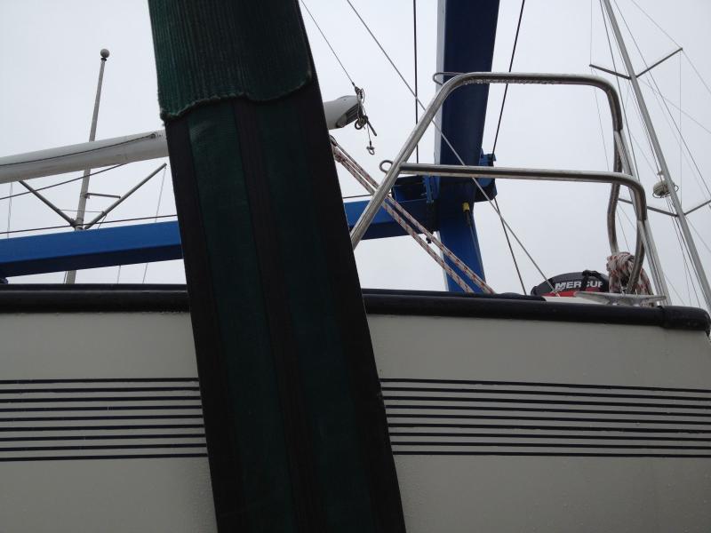

At the new marina, the hoist operator positioned the lifting strap so that it extended partially onto the prop shaft by a few inches. There was some load on the prop shaft, but it didnt appear to be exessive. It is tricky to get the strap completely betwee the shaft and keel as there is little room for leeway on the S2 9.2a.
