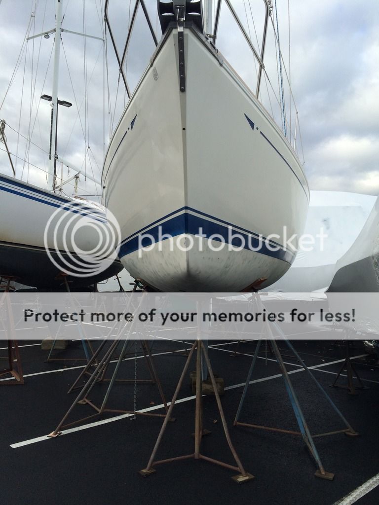

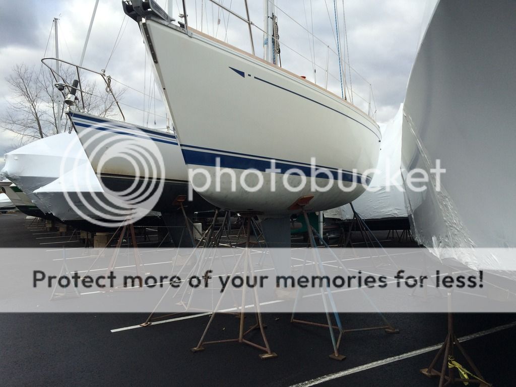

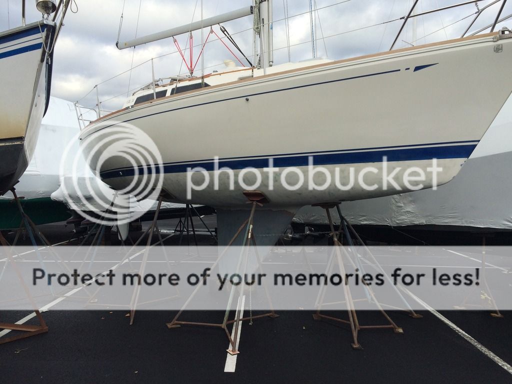

Finally moved up to the top of the to do list, but it's been bothering me since we bought her. Wouldn't be surprised if there were a full 25+ years of paint on her bottom. Been trying to chip away at it bit by bit every Spring, but never had enough time to do the entire job right.
Decided to hire it out and couldn't be happier with the process so far. They did a fantastic job blasting and best of all, under all that paint was a near perfect bottom. Not a blister to be found anywhere. Had the keel rebed a few years ago, so they only took the paint off of it and left that barrier coat in place. Looking forward to finishing the job in the Spring.
She just looks so svelte compared to before.
