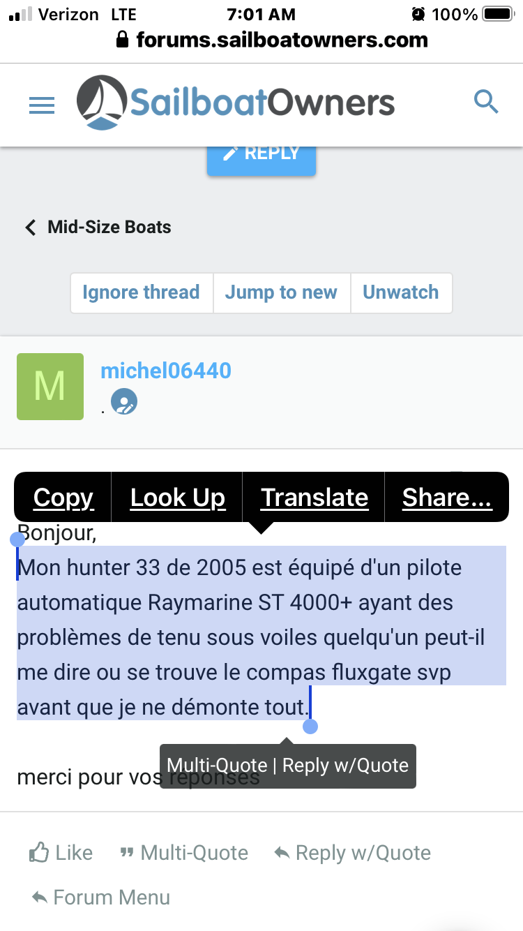

Also, we would request that English be used on the forums. Although we are fortunate to have some people who are multilingual, there might be someone who has the answer but does not speak another language.
If you select the text and hover…. Cut, Past, and Translate come up as options:beer:
Jan 4, 2006
7,443
Uh ............... I don't get out much. Show me how ? This is all I get when I select the text :
Hovering does even less. No one tells me anything and that includes the kids, the dog, and the homeless guy at the end of the street. Nothing :mad: .

I don't get that in Chrome on a PC; however, I do get that option in Chrome on my Android phone. Learn something new every day. Tks,
rgranger!
