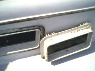

Depends if the breakage is confined to that part of the 'spigot' that extends beyond the frame. A couple of mine cracked all the way into the inside frame. So when I decided to fix them I went completely crazy and bought all new bronze ones. Steve is right, you cannot remove and replace them without lots of pieces breaking. So if you plan to remove them you may as well purchase some new ones. The picture is of one that came out whole, but the outside frame was in about ten pieces.
