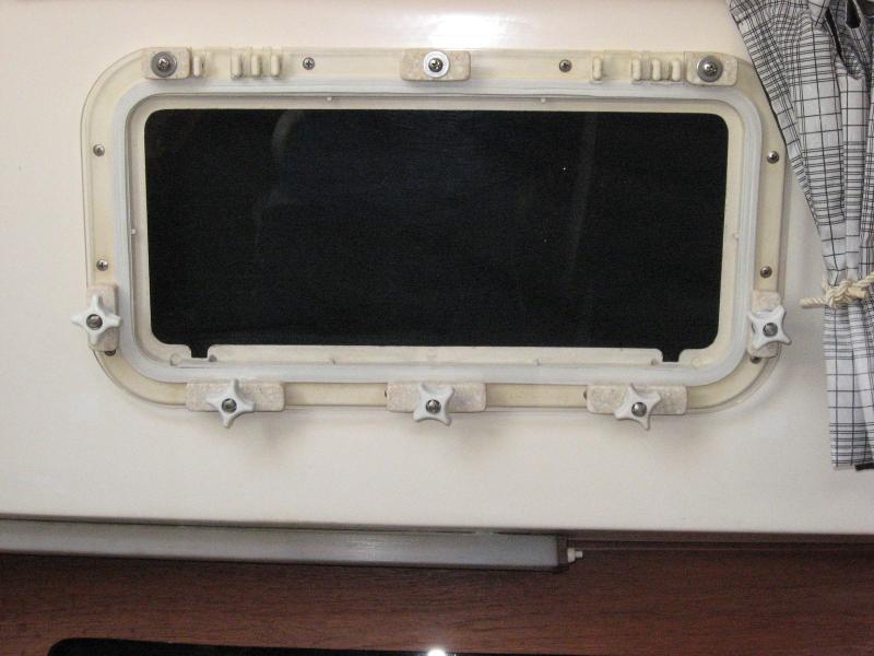

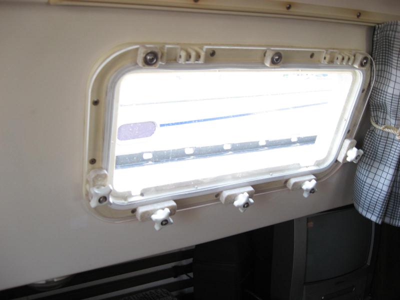

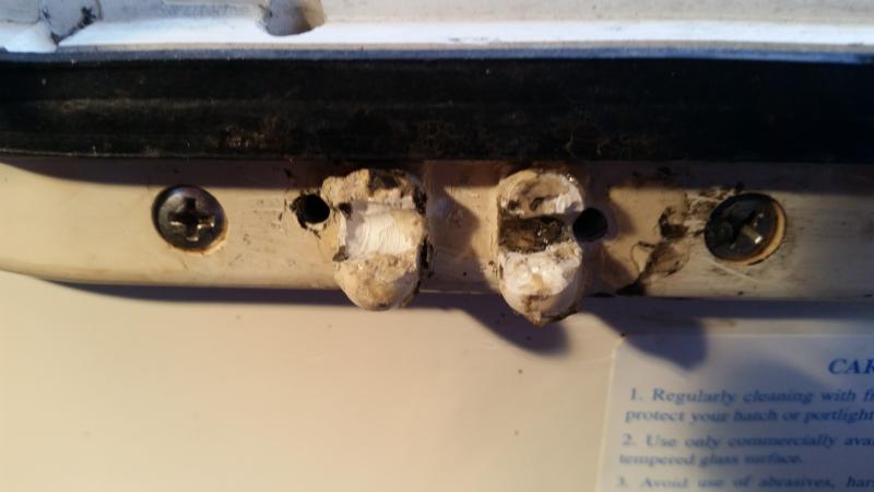

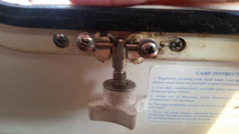

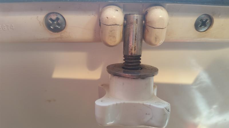

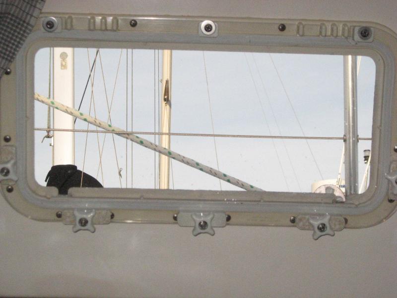

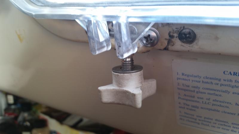

Don't exactly know what to call them, but my classic portlights are secured by thumbwheels threaded on studs pivoting on small-diameter rods embedded in the plastic portlight frame. Problem is, over time, the plastic support for the studs cracks and fails, so it is no longer possible to secure the portlight properly against the gasket.

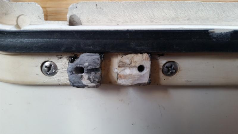

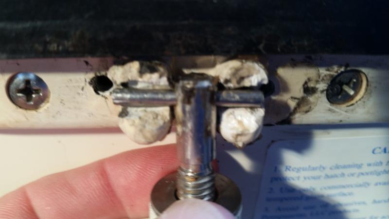

I tried using epoxy paste to rebuild the stud supports, but found that after a few months the epoxy pulled away from the old plastic and failed. So I looked for a more permanent solution.

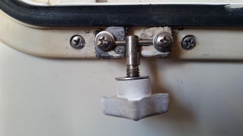

I drilled and tapped 10-24 holes directly adjacent the plastic supports, such that a 10-24 machine screw with washer would hold down the ends of the pivot rod. The tapped hole is thru the plastic frame and into the fiberglass coach liner so is quite secure. I did this both on some supports that I had tried to mend with epoxy as well as some that I hadn't tried to mend. ?Seemed to work well both ways.
Some pics are below.
