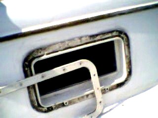

Mr. Underwood and Mr. Timmons have the right idea. The attached picture is of a portlight replaced by a previous owner. The drains were in a different location and he did not bother to fill the old notches. The frame, either glued or screwed around the portlight, does nothing to keep out water. Some water gets in around the rubber seal. The seal is easily replaced. But water also gets in between the spigot and the cabin plywood. Many have removed the portlight to find the plywood completely gone. I had only some dampness. After letting the wood dry I epoxied the entire cabin opening. The final secret is using the proper sealant so no water can get in around the spigot and cabin opening.
