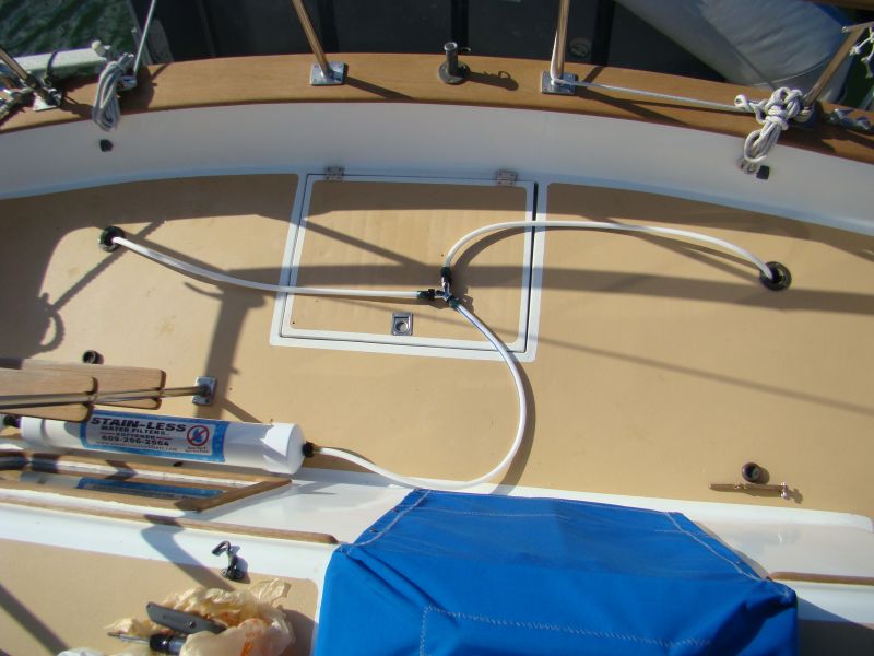

A. water softening by ion exchange does NOT remove chlorine very efficiently (free chlorine or chloramine, which are primary disinfecting agents). This can be done if there is enough carbon, but the Stainless page doesn't say that. In general, they remove divalent ions (Ca, Mg, Carbonate). They do add enough sodium chloride to impact people on sodium-restricted diets (American Heart Association and EPA have standards relating to this).
b. Water softening by RO (whether seawater or tap water) does not add sodium chloride--yes, I know that's obvious--and does not lead to the forever-rinsing to the same extent. RO does generally remove most of the chlorine.
c. While the exact reason aren't obvious, it's well known that IE softened water breeds algae and bacteria more quickly than harder water. If you want a safe tank, you may need to additionally chlorinate to a greater level.
c. Peggy hit the nail on the head; ion exchange softening is going to reduce the number of showers by half!
