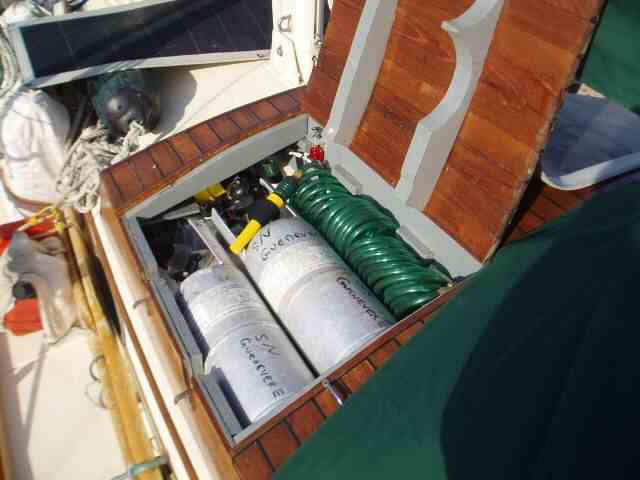

As we were preparing to head out for full time cruising I built a spray hood for our main hatch. I built it wide and had extra space in it. So... I decided to put our wash down pump there, instead of plumbing into the below deck systems.
I can't express how GREAT this has been! One of the BEST aspects was when we were in the Sea of Cortez during the summer. It may sound strange, but by lowering the pickup hose deeper into the sea water (apx. 15 ft.) I was picking up water about 15 to 20 degrees cooler than the surface water (often 95+ degrees 24/7). It was like we had air conditioning aboard! I would wash down the deck during the day with the cold water.
This is a photo of the box.
You can see all the info on the box on our web page in the Outfitting Guenevere and projects page. Including a step by step build.
Greg

Thanks Greg, that is the information I was looking for. I have considered building my own portable pump box. Do you mind letting me know the pump you used? Does it have a pressure switch? I looked at the spray hood project on your website but not much about the washdown pump. Your spray hood is very impressive.
Thanks
551
NorSea 27 Az., Doing the To-Do list
Thanks
No problem, glad to help. The original pump I installed was a Shurflow (I think)I picked up at a swap meet for about $30. It does have a pressure cut off switch built in. So, once the hose is pressurized, the pump stops.
I did have to rebuild the pump switch once after about 4 years of constant use. But it was due to use and salt water inside it all the time, not from being on deck.
