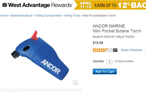

The West marine "Torch" is a glorified lighter. There are small butane torches which have adjustable flame heat and focus and are refillable. Can't give a source but I've used them to solder (Mainesail don't cringe) with good results. And fast - not wondering if it's getting hot or not.
