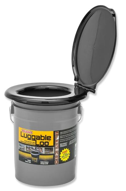

Hmmmm
So what if you used something like this...
You line the bucket with a heavy plastic bag and put an absorbent dry powder in the bottom of the bag. Do you business, throw a scoop of the powder over the "deposit". After a few uses, you tie the bag shut and secure with a few extra zip ties and store the bag in an alternate PVC bucket. Maybe double bag it :yikes:
At the marina, you discreetly "take out the trash". No lugging around smelly stuff. I used to use something similar to this approach camping and we used garden lime as the "powder" but there are some super absorbent kitty litter products that are probably safer and less messy.
Just a thought and less work to accomplish your goal of having an alternative
13,991
Hmmmm
An interesting idea, but I think a little primitive for our lifestyle. :)
