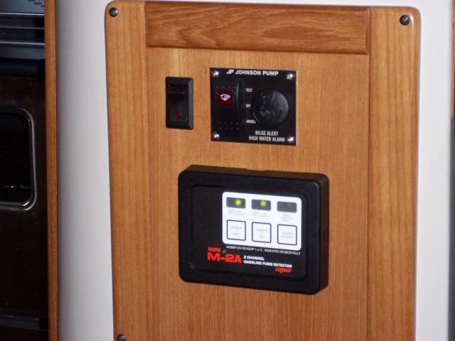

I installed a Xintex 2-channel gas/propane detector a couple of weeks ago. One sensor is mounted in the lowest point of the cockpit locker where I plan to store the generator, and the other is in the aft bilge where I'd expect any gasoline (or propane) fumes to settle. The monitor head and alarm is located on the midship end of the galley sink counter where it can be seen and heard from anywhere in the cabin, as well as from the cockpit. I also have a high bilge water alarm mounted in the same location. Finally, I installed a Xintex carbon monoxide detector and alarm in the main cabin, on the starboard headliner.
I'll let you know how the Honda works out in the next couple of weeks. I'll also snap and post a few pictures of the monitor.
