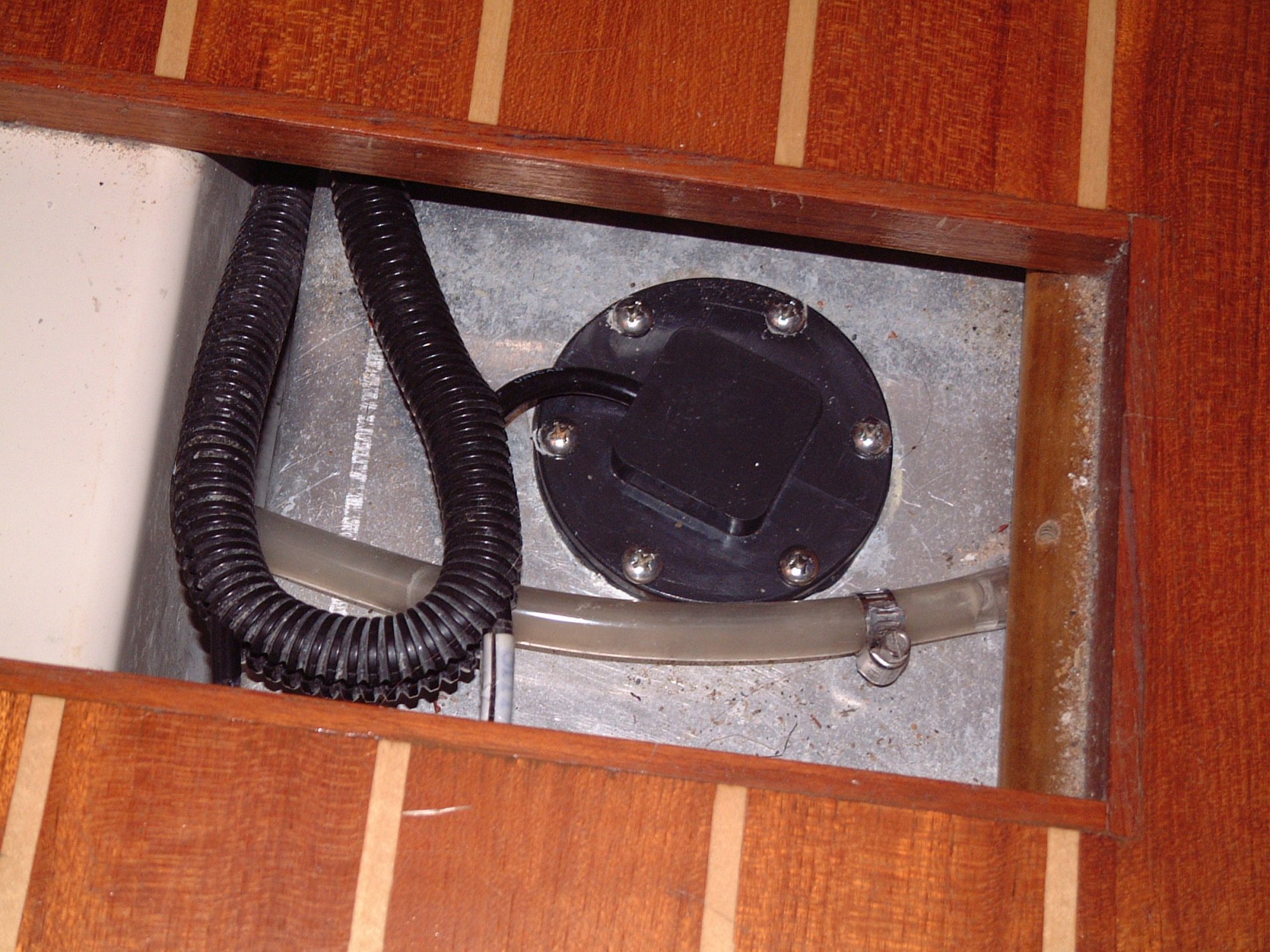

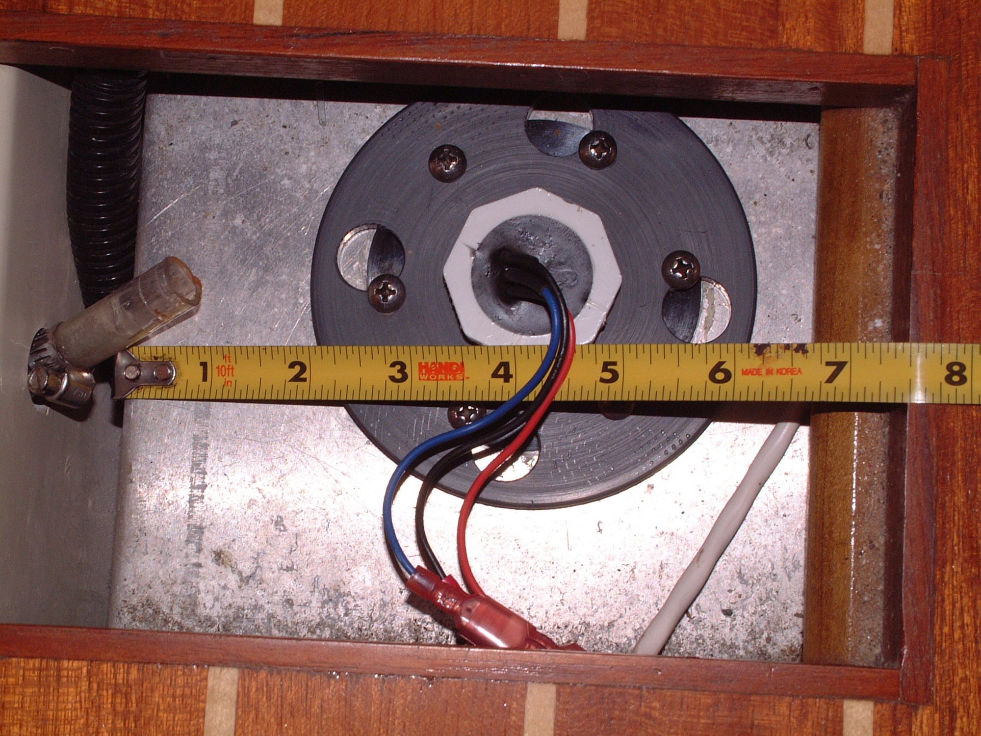

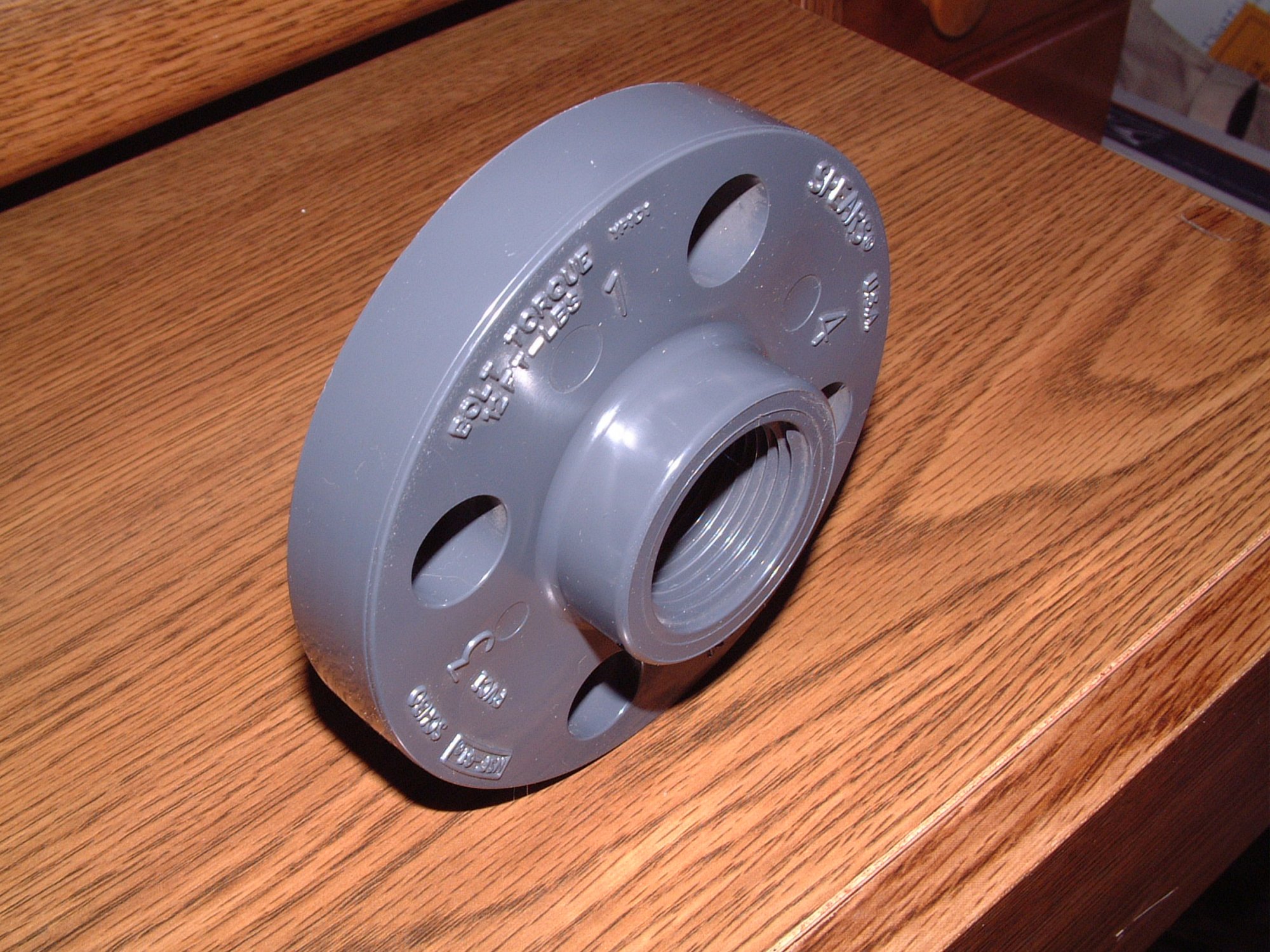

Jim...
When I had a new holding tank fabricated, I had the large hole for the WEMA sensor replaced with a 1" NPT threaded hole. The PVC rod sensor screws directly into that port. Prior to my tank replacement, I removed the WEMA sensor and fabridated a plate with a 1" NPT opening and the holes around the circumference to duplicate the WEMA attachment.
I still have the adapter plate if it would be of use to you.
