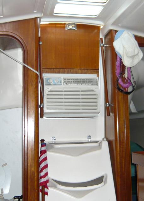

I have used one of the Cruise-n-carry units on my 32-foot catamaran.
I have seen some used marine 5k deck hatch mounted units in the $4-500 range. Does anyone have experience with these?
It is just adequate and I have found that I can leave it on-deck in most weather, but you should really read my blog post to get the details on that aspect: http://sail-delmarva.blogspot.com/search?q=cruise-and-carry
That said, we only take it on long trips in July/August. Shorter trips, it isn't that hot and we don't have the need to dry out.

Just made a lower hatch board to accommodate window unit. Cheap but worked OK. Didn't have to remove it to sail but it was inconvenient getting in and out of the companionway.

I looked at the blog, Drew. Very informative and helpful. If I decide to go with air, the cabin hatch mount seems the most space-efficient way to go. Makes me nervous to even partially block the gangway, though wflowe2's approach looks OK as long as all aboard are agile.
