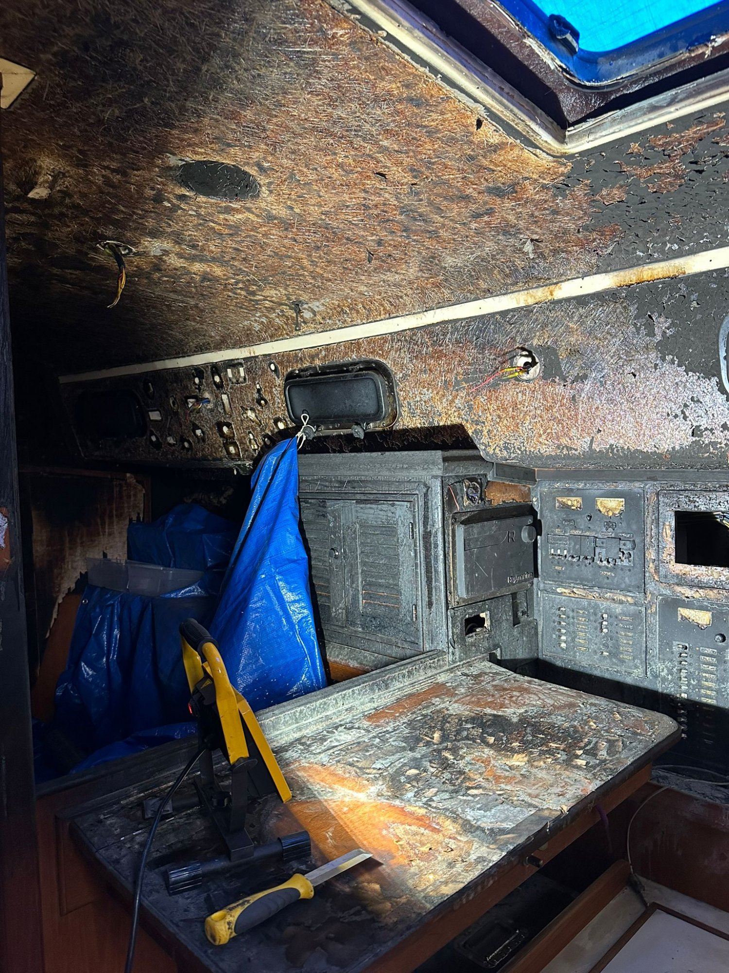

This unit has been talked up a lot in boating forums for a couple of years now.
I need to point out that recently a 48' sailboat was towed into our marina and hauled out. It was completely gutted by fire and a total loss. I talked to the owner and the cause of the fire was his Zero Breeze lithium ion polymer battery suddenly going up in flames. He said it was inextinguishable. It was sitting on his saloon table at the time and he said the battery suddenly caught fire and spread so fast that there was little he could do once the fire extinguishers within his reach were empty. The boat was at another marina at the time, and he said all of the hoses on the dock, along with everyones' fire extinguishers were trained on it, but all that did was keep the fire from spreading to other boats until the battery stopped burning and they could slowly bring down and extinguish the burning boat itself.
Notably, his lithium iron phosphate house batteries were engulfed in the fire and just sat there unaffected. They likely aren't useable anymore, but they didn't contribute to the fire or cause damage in any way.

Thanks - good info, and sad to hear about that. That wouldn’t rule out getting this unit as a base model to run off the house inverter or generator/shore power.

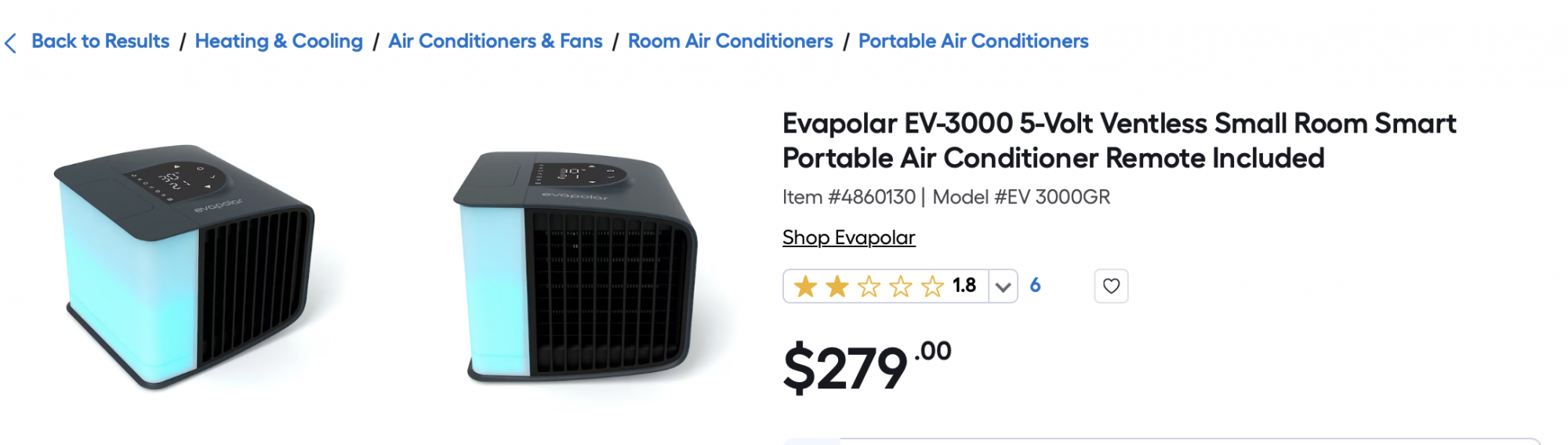

It looks like thats an evap unit
Yes, but local cooling is done, single person type.
It is still effective especially, if you check the price differences. Even for 3 units.
Plus if you have 120 VAC, there many available cheaper than the Unit above'
Jim...
