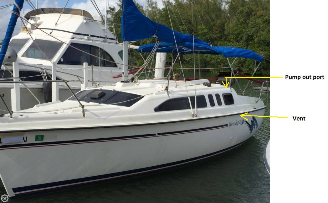

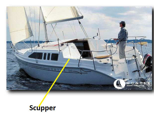

On the Hunter 26, the head's closet is just to port as you enter the cabin. The cabin goes from gunnel to gunnel. So it seems like it would be easy to vent just below the port rub rail right below the scupper.... and put the pump-out port right above and slightly to port of the potty itself... out the top of the cabin roof. All the runs would be under 3'.
