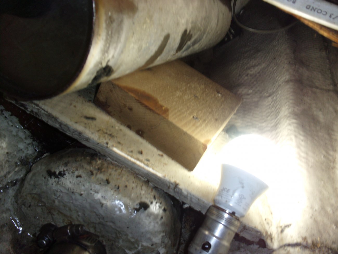

my port tack heel leak was due to a burst exhaust hose right at the thru hull,,the water was running down thru the shell and spills over at the head,,,

yup, I did a visual inspection of the starboard locker,,not a friendly space for a large frame person,,,it wasn't until I crammed myself fully in the locker and checked the hoses with my hand that I found the wires poking thru the hoses,,the hand is better than the eye,, ouch,,,thats when I noticed the collapsed fuel vent hose,,,then I had to get out of the locker, DO NOT grab the deck drain hose fitting,,DAM it broke off,,,,

I have a Hunter 290 and I have also been chasing a leak with water also found in the port head on the floor. I finally figured out, at the end of the season that it was old leaky exhaust hose, which I will have replaced in the spring

was it right at the thru hull????,,,It was fairly easy to remove,,,takes two people, or jump in and out of the locker and engine compartment about 4-5 times,,,feeding the hose thru bulkhead,,removing the engine compartment panels and insulation was a pain,,but the muffler and the 6 ft of hose slides right thru,,the screws for the muffler support board come out easy if you used a stubby phillips and a vice-grip,,,I'll be using hex-head,lag screws when it goes back together. I need 6 feet of hose ,,times 12-14/ft,,,75-80 dollar fix,,,,glad I stayed close to shore during my shakedown cruises,,the port tack leak was very excessive and like most all others, "chasing leaks"...
