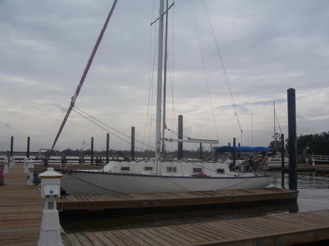

Hi, Its me I found two leaky port lights yesterday during our thunderstorm that cancelled our trip to Ship Island. I also found that some of the others have dogs on them that are about to go or are busted. Would you recommend that I go to a glass shop and have them cut plexiglass and remove all the ports until we can replace all (11) of them? What sealant would you use? I've read in the archives that the 5200 is very hard to remove. There are several things we would like to do to the boat first such as: paint the deck, re-new the teak and replace all of her lines. P.S. I spent 2 days de-funking every inch of her and she smells and looks very nice inside:) B/Seadance

Seadance, Your picture looks like a 33' Cherubini designed Hunter, nice boat, ours is an 81. You probably have Gray Marine portlights you can get replacement gaskets, lenses frames and dogs for them. If you need a short term way to fix leaks you can put a small bead of clear bathtub silicone caulk on the black gasket in the frame and close the port and leave it shut, the silicone will peel off later with out too much trouble. If the boat is a "long term" addition new ports are in your future. Then your options are only limited by ambition and budget! We put in 11 NewFound Metals all stainless ports last year, (The change from crazed tinted platic to clear tempered glass is astounding! [The change in your bank balance is also astounding!] ) Check the Photo/Project Forum for more ideas.

Sweet boat...
in an empty marina. Well done Seadance.
