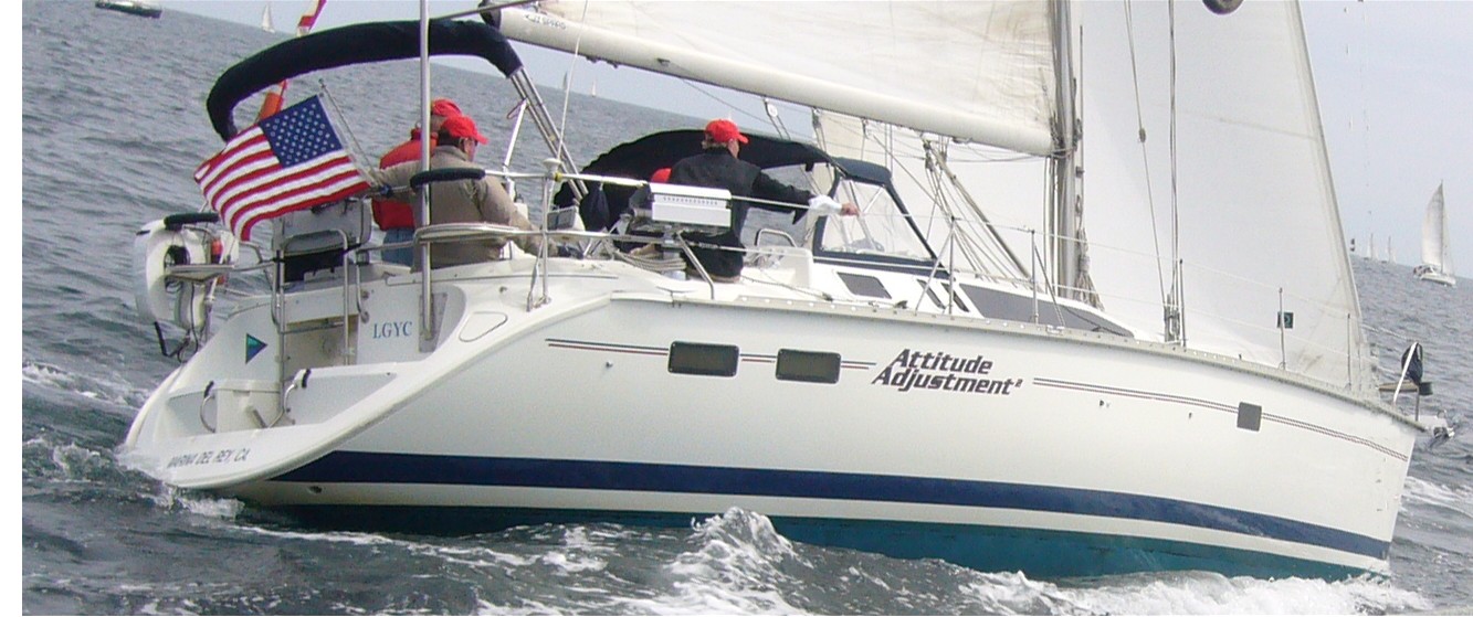

I would like to put the name on the hull port and starboard close to the transom, and the port of hail on the stern. Is that allowed? That's how it has been on the boat but I am unclear how to interpret this regulation (or whether anybody cares). There is not enough space to put both on the stern (swim ladder/platform is in the way).
attached a picture from the internets with a similar setup. The name would be further back than this example.

I haven't seen name and hailing port done that way, but your plan does seem to be in compliance with USCG regulations.

C42 has 3 ports in front of the mast. C36 has 2. The image showed 2 ports. Is the 3rd one hidden in this image due to the angle of the photo? In any case there is plenty of room on the transom for hailing port lettering.

Just my interpretation but I would say that them saying "...name and hailing port must be marked together on some clearly visible exterior part of the hull" to mean that you coudn't have the name on the side of the huill and the hailing port on the stern. That wouldn't seem to be "together". I would think both name and hailing port would need to be visible together at the same time from the same direction.

I cannot recall seeing a documented sailboat in SoCal with other than the hailing port on the stern and name on the P & S quarter unless the transom had enough space to put them all together. FWIW.

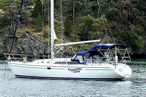

Small world. I just saw that yesterday and thought “that looks nice, but I don’t remember seeing it before”.
I bet If you’d turned the camera around from that shot you’d see this -

Catalina Catalina 42 Havre DeGrace
I saw your boat when I was there a week ago! I live a bit away but will be on board over summer quite a bit - see you there!
this is correct - I got the explanation direct from the coast guard during an inspection - Because my Hunter dealer had the name on the sides and the hailing port on the stern. they conflated the commercial and recreational rules... The name and hailing port should be together in letters at least 4".
