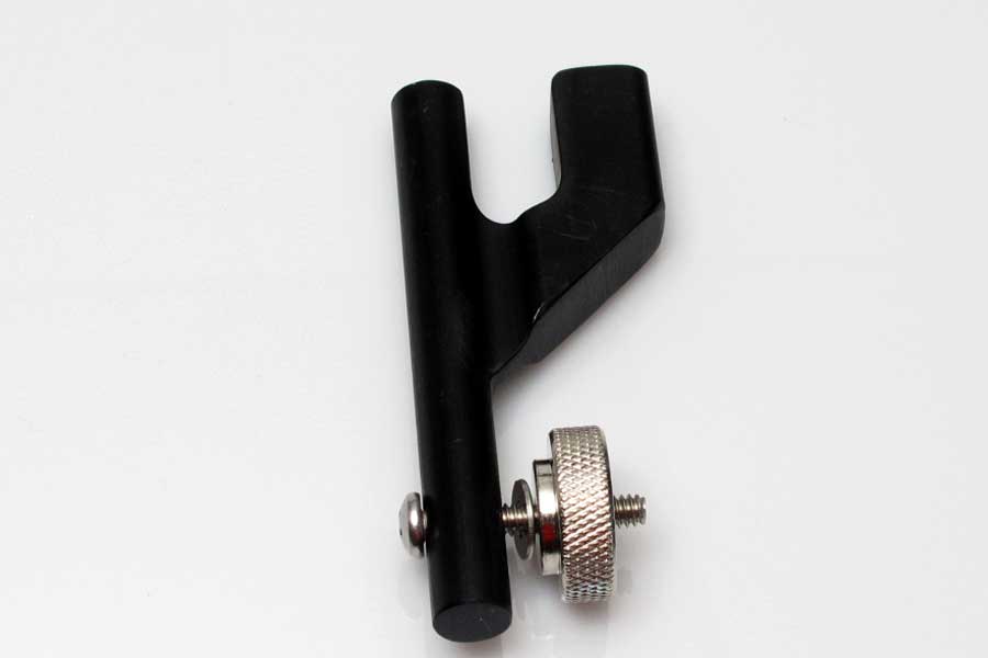

The only difficulty I can imagine with raising the pop top might be the weight? Once raised, there is a thingamajig on the mast that secures the pop top up and against the mast. That thingamajig is prone to being lost though, so if you don't have that, it could be problematic because the pop top could then come crashing down unexpectedly. I had a C25 before my Beneteau, and I also now have a C22 myself, so I'm at least somewhat familiar with the mechanisms, although I don't use them very frequently. Good luck in figuring it out.
