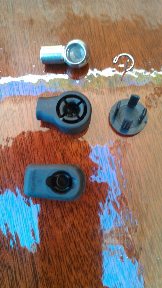

How do the end fittings work ?
The gas springs I ordered, came with composite fittings on them.
I ordered stainless steel ones, and locking clips, to use instead.
Unlike composite ends, stainless ones don’t usually have built in clips to keep them on the brackets’ ball mount pin
Gas springs normally allow various end fittings to be threaded on.
To change them, you simply thread the old fitting off, and thread the new one on.
This is great if you want to upgrade the fittings, or simply replace broken ones.
All you need to do is make sure the end fittings have the same threads, and are the same length.
End Fittings examples: Stainless +Clip, Composite with clip, standard composite with integral clip.
