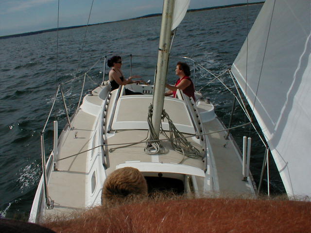

Genoa car OK, I think
Attached is a photo of the boat under sail. As you can see, I think the track is as far back as it needs to be, but perhaps there's too much belly in the sail.

Maybe Sail is cut wrong for boat
Tim, From your photo, it looks like the block for your sheet is as far aft as possible for your boat--which still may not be far aft enough for the cut of this particular sail. I.e., the clew is too high and the foot is too long. I think you could still have a 150% genoa but with a shorter foot and lower clew which would theoretically allow you to get the sail much tighter without having your jib car hanging off the stern rail. The trade-off here is that the leech of the sail will be longer, bringing it closer to your deck and cutting down on visibility from the helm forward (i.e., more of a "deck sweeper"). I had the same problem on my O'Day 22 with a supposedly stock 155% genoa--it was cut with the clew about 2 to 3 feet off the deck and a foot length that would have forced me to have a jib car about 2 to 3 feet behind the stern of my boat in order to sheet that sail properly. (Maybe I could have given it to you since your boat is 3 feet longer???) I then measured myself for a better fit, effectively bringing the clew down about 2 feet and forward about two feet, lengthening the leech and bring the sail's foot closer to the deck. I can't see around the sail very easily (that's what crew are for) but I can now keep my jib car much more forward and still get a decent sheeting angle on the sail, allowing me to point where I could not with the other sail. Talk to your sailmaker about this and see what he says. Rich s/v TIME BANDIT O'Day 22

Wait a minute ... If you have to attach
the gib sheet to the stern cleat ... what do you have to do to attach a gennaker? And since when does a 150 clear the life lines up wind? Great photo raises lots of questions. Vic
