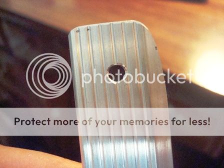

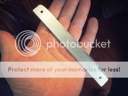

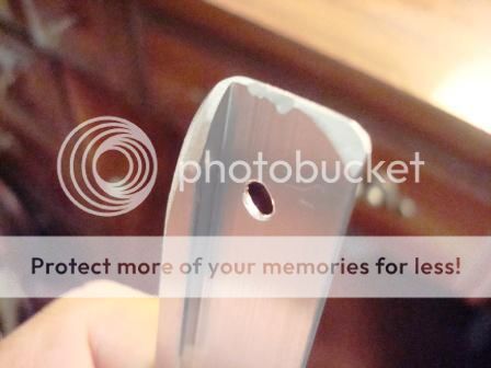

Took me a while to figure out why I couldn't get the mainsail up without all the sliders falling out! Woes of newbiedom. After looking around a bit, I found you had to make or buy a "mast gate" which is used by dudes who keep their mainsails attached, rigged, and covered when not sailing.
Anyway, for any other new folks, here's my home made version. I think I bought the aluminum carpet transition strip from Ace. I drilled and tapped two small holes into the mast so I wouldn't have to use sheet metal screws.
The wide part of the slot just above the boom needs to be filled with the thick part of this strip.
You just cut off a segment with the hack saw or dremel, and then curve and smooth the edges with a file or bench sander.
I'm trying to save my pennies, otherwise I would have just purchased the pro one that hinges.
FWIW
Stan

Very elegant. Should be THE "Top Ten Tips & Tricks" on the Catalina 22 Owner's Association website, first thing everyone sees!
Great job. And well presented.
Anybody searching this site for "mast gates" oughta come right here! :)

Mine is similar but made of ss. I had to move the screws from the face of he channel to the side of the channel, the slugs kept hanging up on them.
The gate is really handy when reefing in rough seas. Not having to mess with the slug stop makes the whole process safer.
