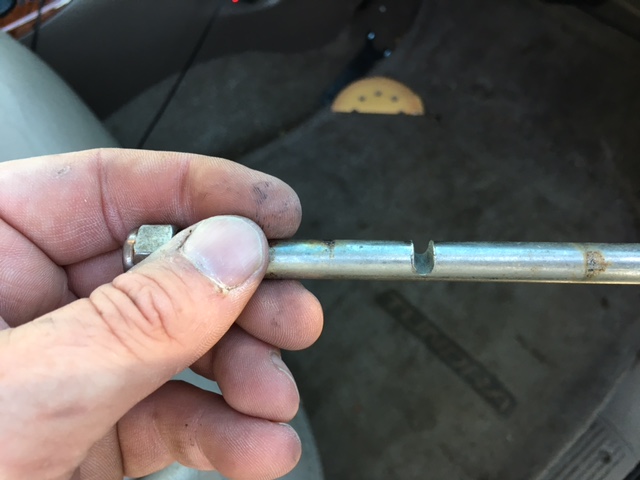

I use them too, work great on board! Their 50' nylon fish tape is also really useful
May 20, 2016
3,015
Yup those rods are the best thing. Much better than a pull string or fish tape. I used them on my mast

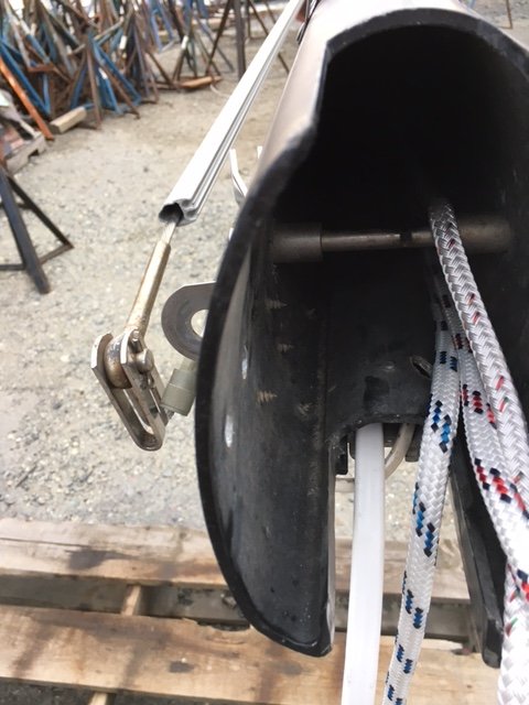

I got both the 33" fiberglass rod kit and the 50' nylon fish tape ($7). The later worked fantastically for doing the 90 degree turn for the steaming light. What I had struggled with was literally done in two minutes. Regarding the fiberglass rods...I really should have bought two at that price to get all the way through the mast. Especially since the mast is bisected by through bolts and the steaming light tube and I wanted to run the headsail halyards on one side of them and the main halyard up the other side. Got it done though. I have a metal fish tape and I taped it to the fiberglass rods to get the extra length. Pulling the mast head was easy and necessary to get it done right. I took the opportunity to service the sheaves. I cleaned them up with a wire brush and sandpaper and then greased the sleeves (no ball bearings in them, just a sleeve) and re-installed. I reused the original Perko steaming and mast head lights in the name of economy but put in new bulbs and lenses (~$20 each). One surprise was the the wire/rope halyards had literally sawed halfway through the bolt that passes through the tangs for the port and starboard stays! Luckily a nearby hardware store had the necessary 3/8" x 5.5" stainless bolt and new nyloc nut.
Another surprise was that the PO had attached the VHF antenna with three sharp ended stainless screws. They look like wood screws. Get a tap and die set folks. They are inexpensive and the screw ends aren't sharp! Note that in the photo there is a hold in the wire chase near the blue flecked halyard. That is to run the mast light wires through. As a bonus it provides strain relief. I should have taken more photos.
