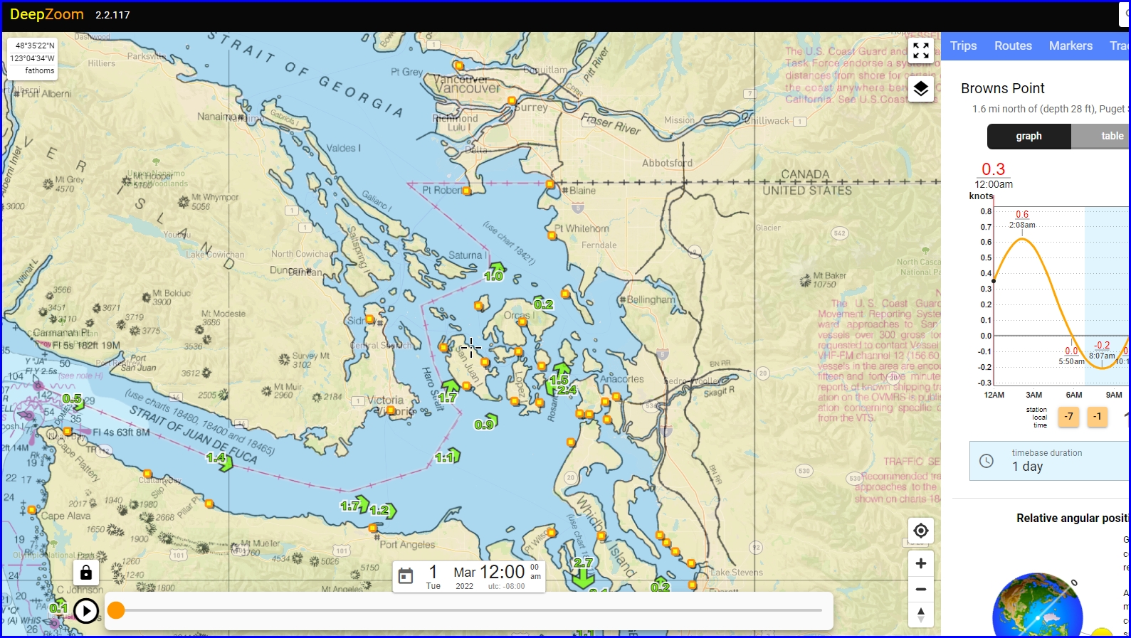

Have you checked out Deep Zoom? It's a web site, but works on my iphone and has some cool features with the green arrows showing currents over time at key points.
Not sure about Canada though, might not support it or is a setting I don't have correct...

DeepZoom looks great for when I make trips to the south, but the current data seems to only go to the border. Too bad, it looks handy!
