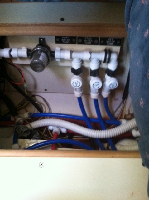

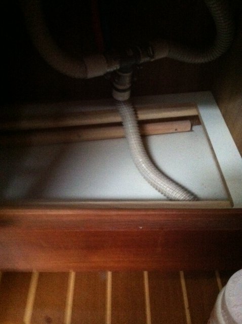

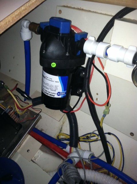

Ok I found the issue to be the pump. I replaced the pump and all is good. There is no manifold under the galley. Attached are the pics. I visited west marine store and they sell whale fittings for future reference. The pump is a jabsco with push in fittings on either end. I capped the old pump right at the pressure side and it cycled every 15 min. must be internal to the pump. New pump solved the issue.
Thanks

Ok, I was just going from the user manuals. Obviously you know more about the 410 than I do.
The manifold for a 410 is right where the user manual says it is! I don't really understand you think it would be the same for a 49.
