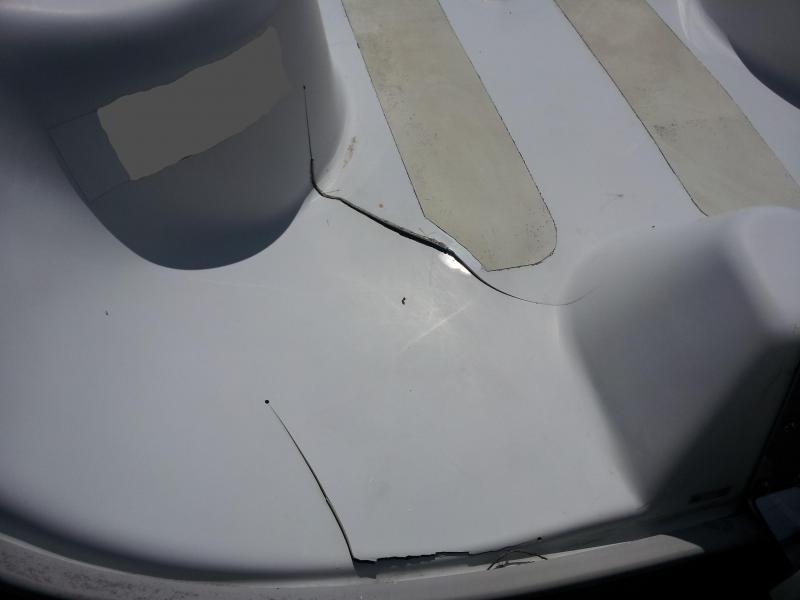

I have attached a couple of pics that show some of the worst cracks, and the attempts someone made at fixing them. The last inside picture shows that there seem to be cracks around the mast step, and in the bow as well.

Thanks for showing the pictures. I think I would stay clear of this as well. It looks like a repair has already been attempted and botched. Those cracks look like they were caused by tremendous stress rather than fatigue and/or weather, like most ACP cracking. While it could be repaired, they are pretty extensive and might be more trouble than its worth. I honestly think you'd be able to find better value elsewhere.
Jun 17, 2013
3
Hunter 170 no where yet
Thanks for the input. I always thought the hunter day sailers looked awesome with the open stern, and got caught up in the allure of a cheap boat. I guess I will just save my money and wait for one of the new fiberglass boats to come up on CL.

We bought a used 170 three years ago, about $2000 including trailer (yes, I think it was a steal). It has some small cracks in the lower inside corners of the forward cockpit and along the floor of the main cockpit area. These areas feel "soft" underfoot, like there is no support under the plastic shell. Compared to the photos posted above, these are very minor and I think they are cosmetic only. I have to agree with others, the boat shown above is a bad idea.
