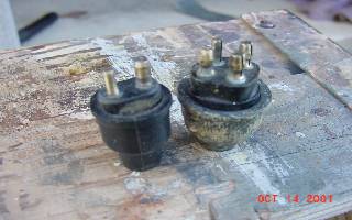

79 H33 mast wiring connectors
marvin, I have a 79 H33 and have recently redone all of the mast wiring. The photo below are the male sides of the connectors on my boat. Single is the anchor light, double is the steaming and deck light. They are connected and taped when the mast is stepped. Since you have voltage in the bilge, these connectors which were pretty oxidized on my boat when taken apart, seem a good possibility as a voltage loss culprit since loss is possible in the connector itself and in the wire connection to the connector. You have a great boat. I like mine more all the time.
