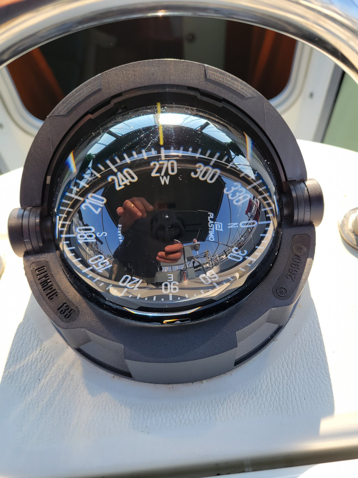

My current compass leaks over a season. Tired of trying to refill.
Has anyone swapped out this compass for a Ritchie Sport 2000, which is about the same size as the original.

OR get it rebuilt by Viking Compass.......that is what I did on my last 3 sailboats.

My understanding is that the Plastimo compasses cannot be rebuilt. Indeed, I do see small cracks in the underside liquid chamber at the screw hole- I really think this is toast. No spare parts are listed anywhere.

Had the same isse finally broke down and bit the bullet and bought a new one . Mine sits in a hole on cockpit table and could not find one large enough to fit hole . I could have used starboard to shrink hole, but opted to just buy a new one. It was 25 years old
